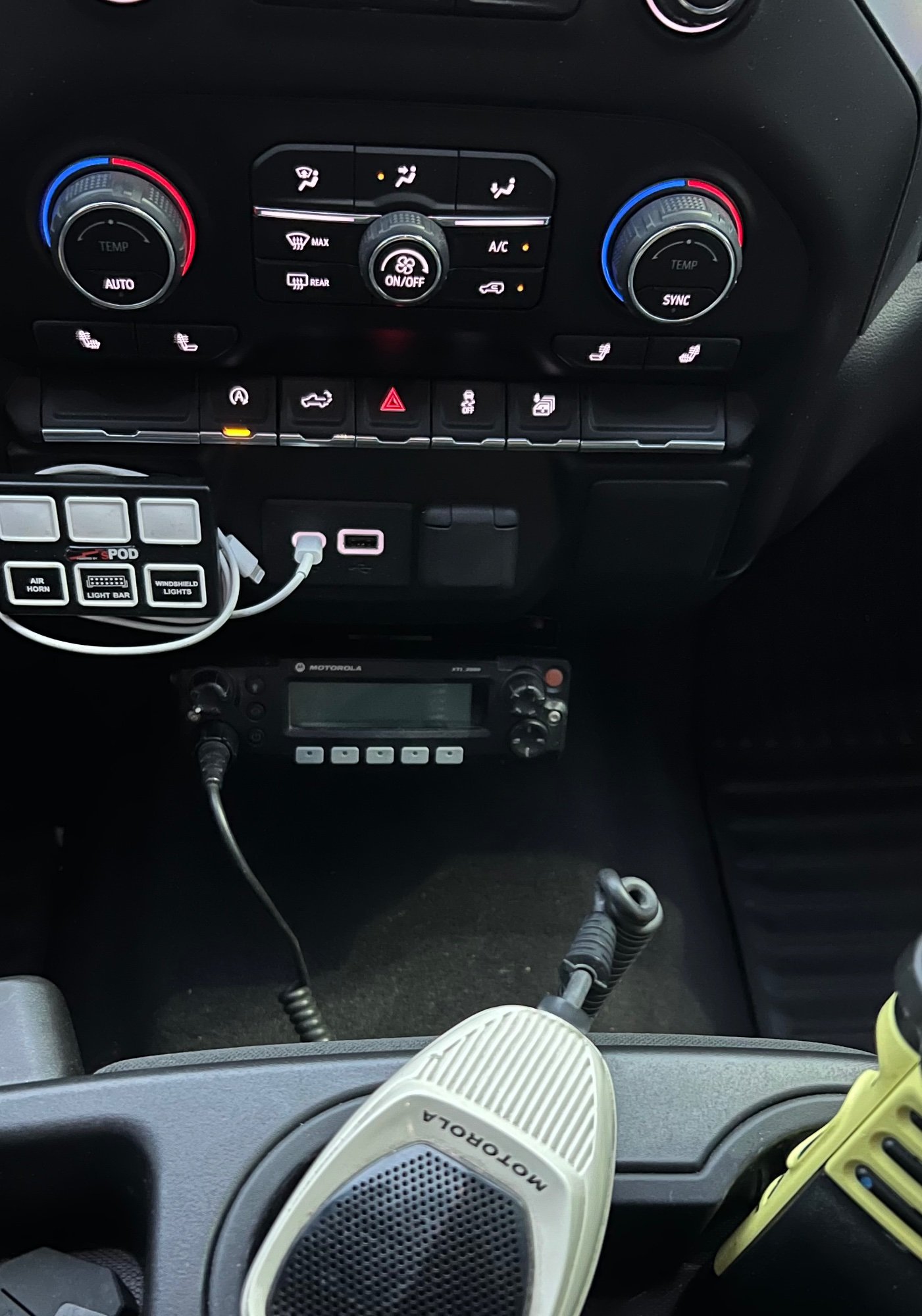

  3. This is where my radio system is mounted. Motorola XTL2500 UHF p25 system. The main radio “brick is mounted under the rear passengers seat.
