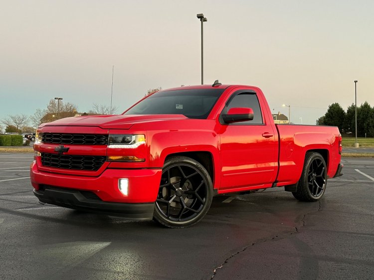

  9. I've had these MRR T228 for 2 months now and have been at the shop 4 times to diagnose a shaky wheel/tire combo at highway speeds. I had Toyo proxes st tires and went thru a combination of 7 different wheels and 7 Toyo's before the shop ordered some Nitto's the same size. The Nitto's were put on and the truck STILL shook so we put the stock 18's on and the truck drives great, NO SHAKE. Any help? MRR is to the point they almost don't wanna help and I'm having to look into new wheels. Anybody went thru the same thing?
