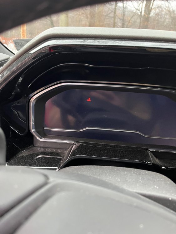

Thanks. I do have the temp gauge displayed at bottom of the display. It showed normal when the temp light was on. Not sure if the 6.2 has more than one sensor?
The other day the temp light came on but gauge showed ok. 35F degrees out. Not towing. No check engine light. 2022 ZR2 6.2 13K miles. Light stayed on when engine was shut off then went off. Coolant level was ok. On restart the light lit with all the others then went out per normal. Has not happened since or before. The menu doesn't have an option that I can find to display engine temp just transmission.
