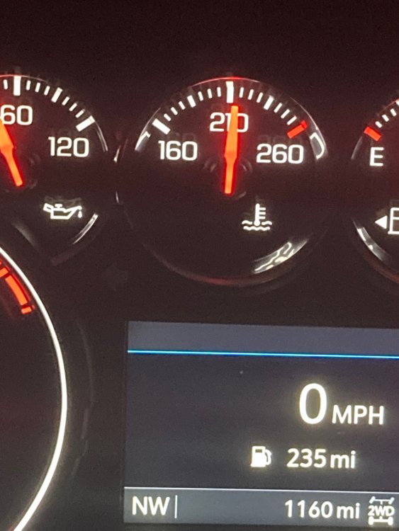

  23. Temp gauge on cluster steady runs at 210 or slightly over with no load or trailer even in sub zero temps. Just curious if this is what anyone else is seeing? Had a bad cylinder head replaced with less than 100 miles so don’t kno if I’m over worrying everything now or if this is normal ….thanks
