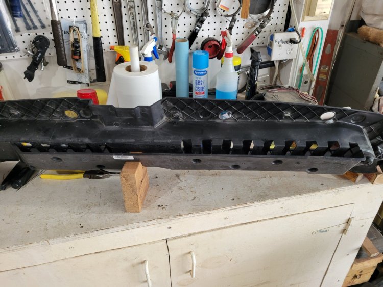

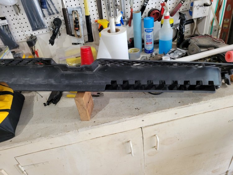

  4. I asked in a thread Cold Air Intake if anyone seen the Stillen replacement Air scoop. Well after looking at their replacement scoop. I just modified my OEM scoop. Didn't think I wanted to spend over $250. So I modified mine kind of to be like theirs. In the area that goes to the filter box, there's a little wall. I removed it. Then I took the scoop out of the truck. 9 pop pins and 2 T15 torx screws. And seen that they only had half the front opened up. So I cut the flap off and open the other side. Then reinstalled it. Here's some pictures.

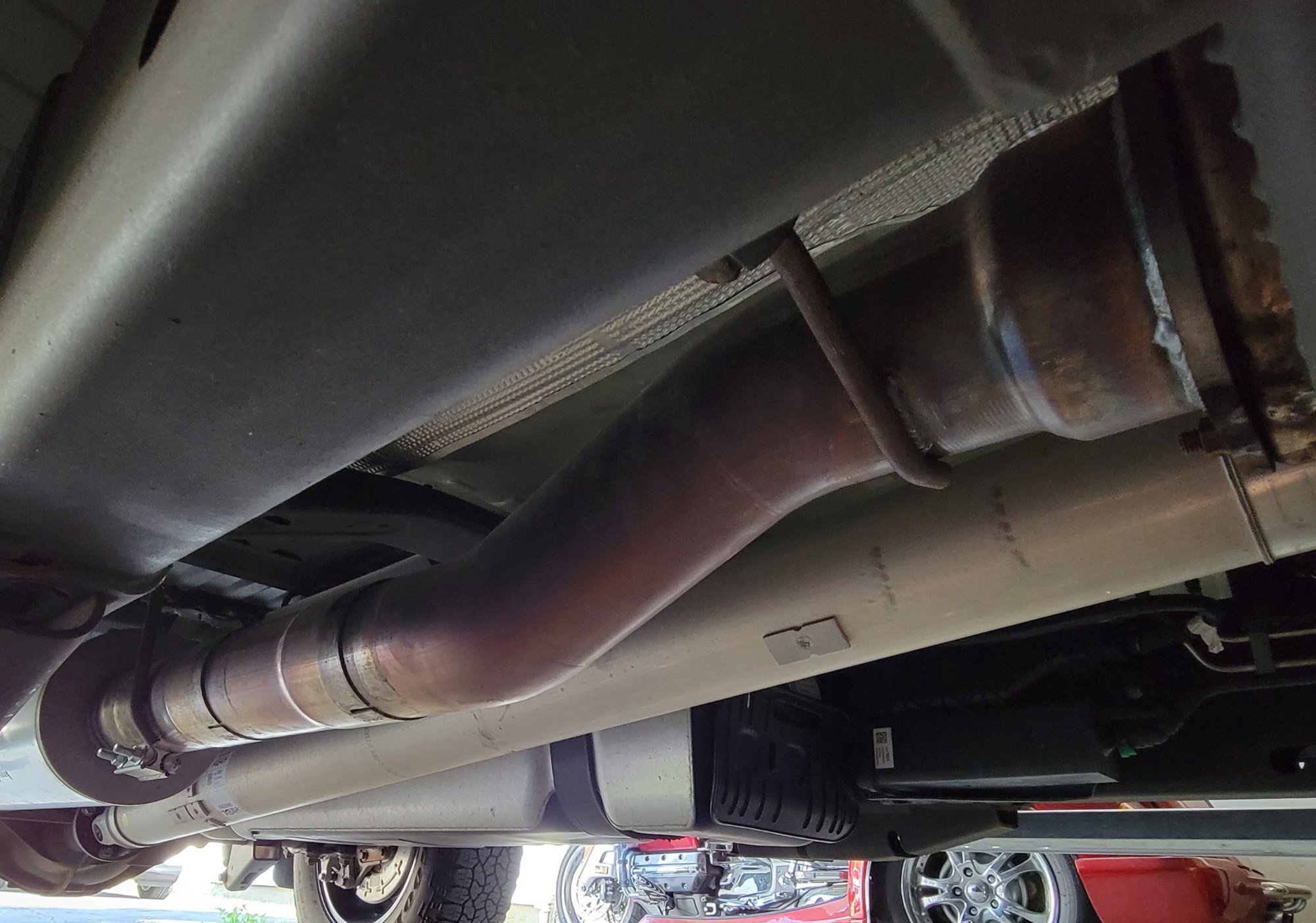

  12. Here's the pictures that I have. Remember this is a crew cab and standard bed truck. These pictures were taken with the clamps off. Started working and remembered to take pictures.

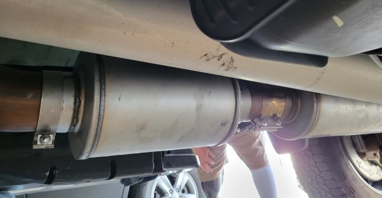

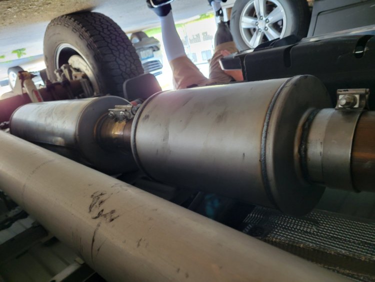

  13. Ok, we have installed the little muffler. A lot of the drone is gone. There is a little in the 1500 to 1800 rpm range. It is quieter, but sounds good when you get on it. Even when pulling camper. The muffler is straight through just like the main one. It's close to stock with a little louder volume. The exhaust system kit came with a 4" inlet and a 5" outlet. I did change that to a 4" outlet chrome tip. So overall it's quiet at idle and a good sound at highway speed. I'm happy with the setup. I think it's has better throttle response and gas mileage is a little better too. This is a 4" exhaust system, flange all the way to the tailpipe. I have some pictures, but I'm on the tablet and they are on my phone. Post them later.
