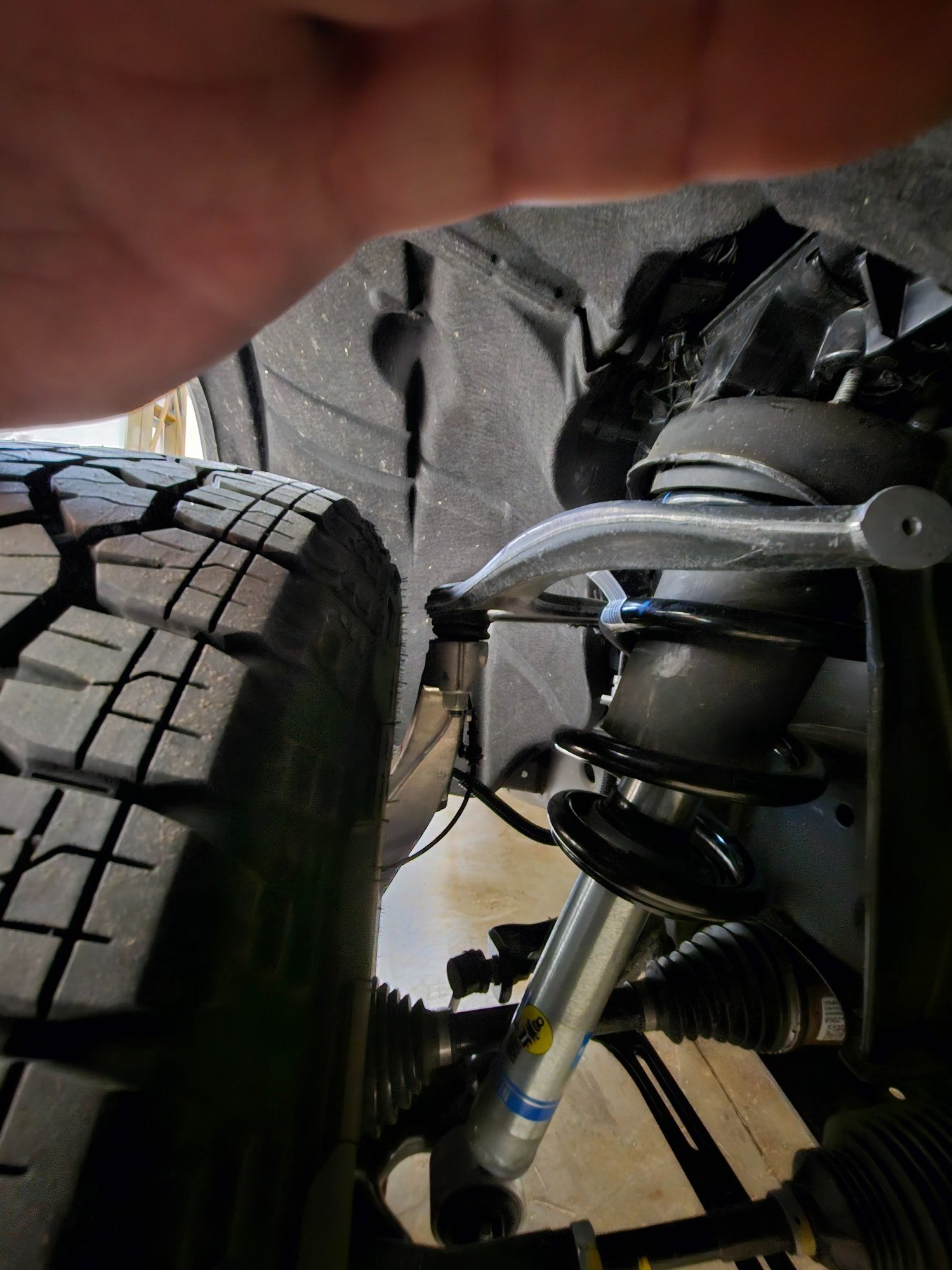

  6. OK. I thought I would try this way first and I didn't think the angles looked too bad.

  8. Just installed bilstein 5100 At4/TB front and rear strut/shocks. 2023 GMC Elevation. Set struts at .55 middle setting in the front and 2 " rear blocks. So total of 2.55" lift in the front. How do these UCA and CV angles look. Trying to decide if I should upgrade the UCAs to aftermarket. Thx.
