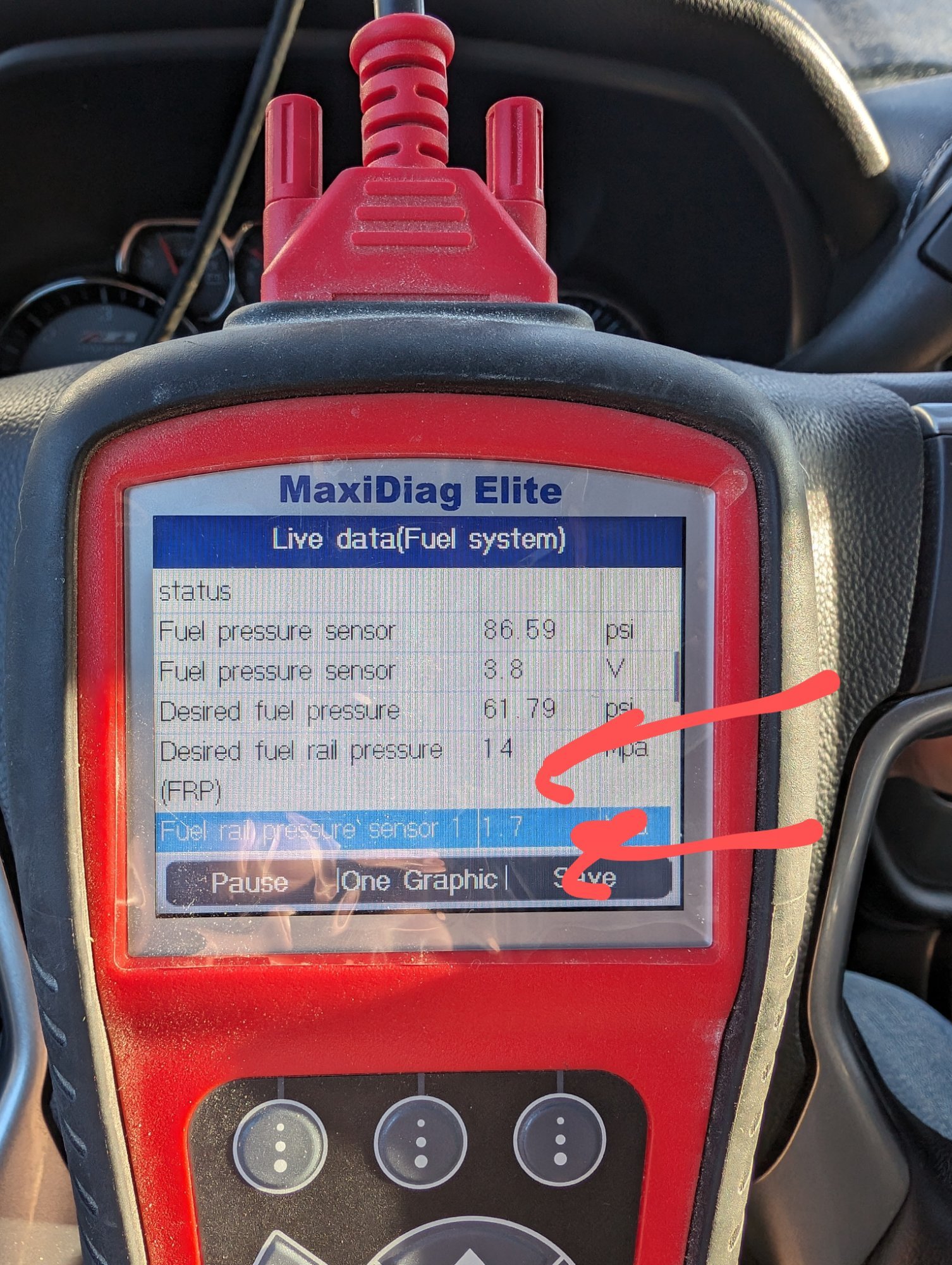

  1. This is during cranking, does it hit the desired fuel pressure while cranking?
  2. I don't think my scan tool will update for the 2014 model, is there a port to test pressure manually, or is this for the high pressure pump?
  3. Yes it restarts, but seems to take more cranking. It also runs poorly for those few seconds it runs
  4. I will try another key thank you! Is there a port to test fuel pressure on these engines? I assume it doesn't tell the story as I won't be able to test the high pressure pump, but since I don't have any engine codes hopefully it's still good....
  5. Hello, During a cold snap -35c I remote started the truck twice and the wife drove away in it and made it about 10 feet before the truck died. Now the truck starts occasionally and runs for only 2 seconds at a time. The truck already went through valve springs a couple years ago with limited kms out on since. I have started doing a compression test, in my limited time and have only done 3 cylinders so far ~140 psi. I am looking for some ideas to check tomorrow after I finish the compression test, assuming I find compression to be in spec of course. Thank you for the help!
