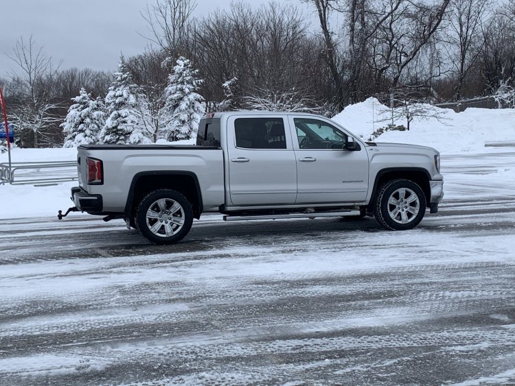

Well got to test the tires in snow yesterday and today. We got dumped on, about 20". Remembering that these are not snow tires, but do carry the severe weather rating, I was curious. They did very well. Shockingly well actually, but they are new, so lots of tread. So far, 300 miles in, I am still thrilled with these tires.

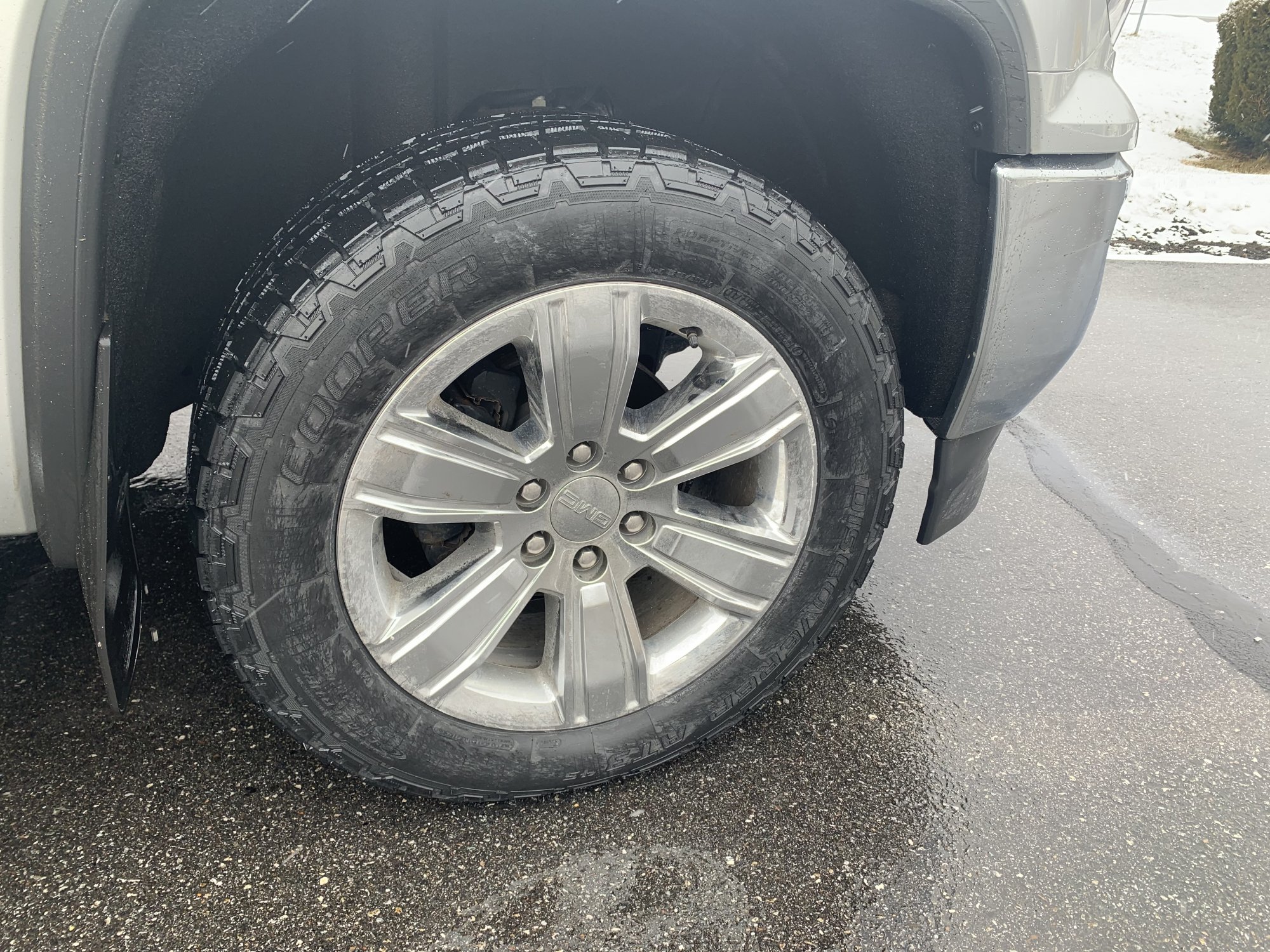

I just bought this truck from my father in law, and it was in need of tires. I read TONS on this site, and ultimately decided, between what I read here, and reading reviews, on the Cooper Discoverer AT3 4S tire in the XL load rating (117). Granted I only have about 25 miles on them, but initial impressions are very positive. I love the way they look on this truck. Not too aggressive, but way nicer looking than the junk GY SR-As they replaced. So far they are quiet, and great snow traction (they were put on while it was snowing out and roads had a couple of inches on them). I looked at BFGs, General, Bridgestone, etc, and decided on these. I looked at the Cooper AT3 XLT as well, but felt for my truck there were too aggressive. I do 90% on road, so didn't want to kill mpg. We will see how they wear, but so far, very happy. I will post updates as the miles go up. Here's a few pics, but I think they don't do it justice, and from the rear, it's almost too dark to even see the tread.
