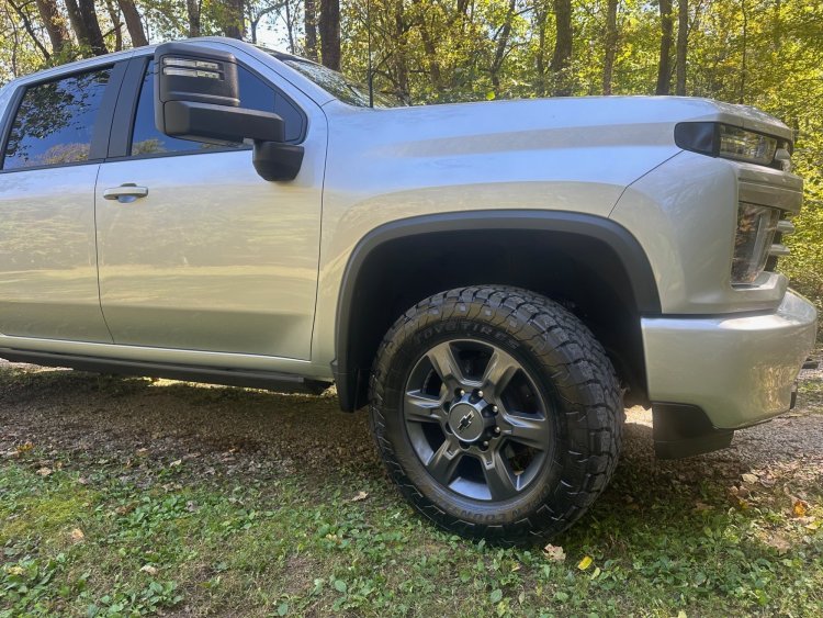

finally put the new wheels and tires on. The new tpms sensors didn't work when I first put the wheels on; truck wouldn't recognize them when I did relearn. I had to take the truck back to tire shop with the factory wheels/tires in back so they could figure it out. They were able to copy the signal from the oem sensors and then program the new ones to work with the truck. Took them about 20 minutes and now all is well. I gotta say, 35's still look kinda small on these trucks. -
