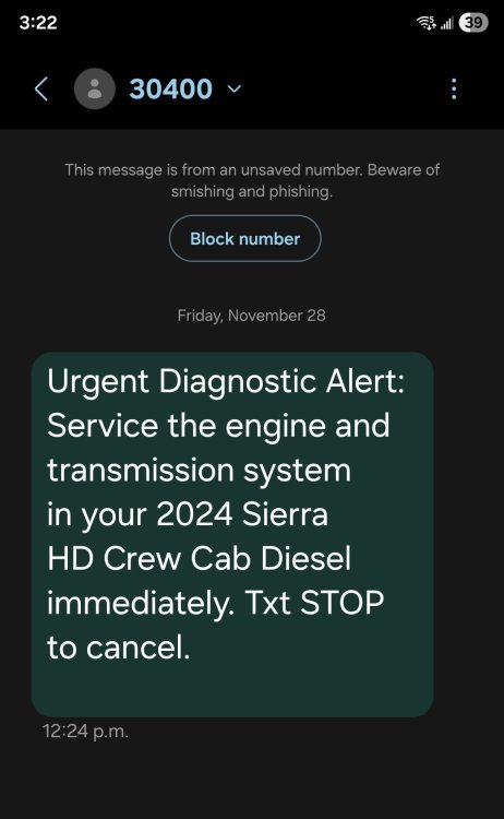

  6. Well here's another one. Driving down the highway when the truck suddenly loses power. Takes me a sec to realize the truck isn't running. DIC warning 'put shifter in neutral and press start button'. Nothing happens. Manage to strongarm and stop this beast in the center of the highway (middle turn lane so somewhat safe). Put the truck in park and tried the ignition. Engine turns over but will not start. Phone gets the text below. I really do want to love this truck, but I think I got a lemon. Three times prior speed restricted with the last fix a replacement throttle body. And now this. Towed to the dealer (though out of range so I am on the hook for the extra distance not covered by the warranty). Funny that the first truck couldn't take it as the electric park brake engaged as soon as he put it in neutral. Had to call a flat deck. Or so he told me- I took an Uber home long before. Anyways, thought I'd share another fun experience that I have had with my truck.
