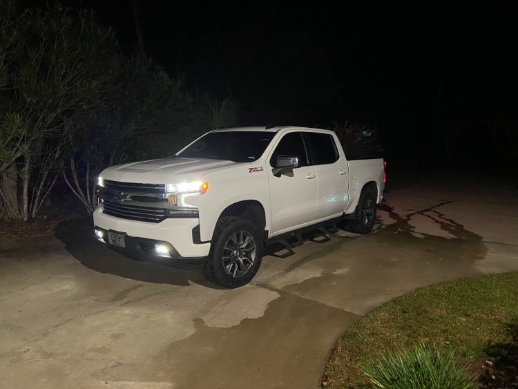

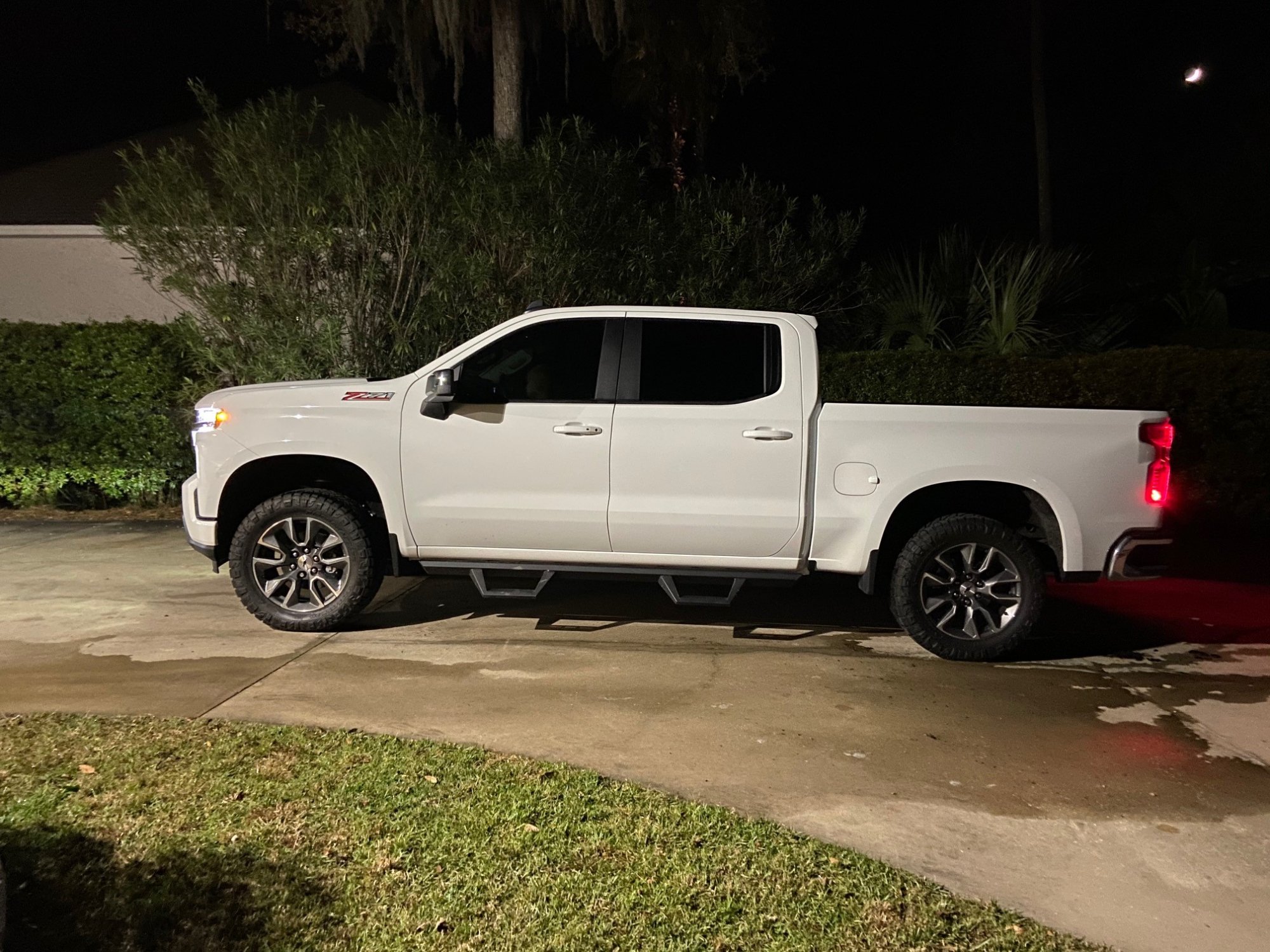

  22. I took off my 2" Rough Country lower strut kit and installed the 2.5" motofab upper which was a pain in the a&$ doing by myself. I also installed a 1" block in the back awhile back. Here are some after pics finally. Shouldve waited til I washed it but you cant see the dirt lol thats why I got a white truck.
