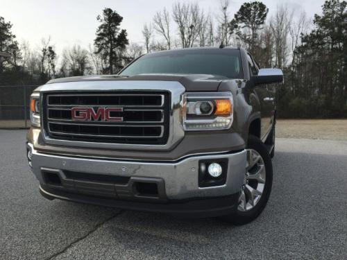

I've been working on my 2015 Sierra SLT and thought I would post a few pics of it so far. I started with a Borla rear exit touring system and Belltech 3/5 drop, added KMC 22 inch wheels with 305-40-22 Grabber UHPs, a BackFlip G2 Tonneau, a Bedslide 1000 SE, 30% tint all the way around and Putco fogs and backup bulbs. I took off the factory oval tube running boards and temporarily installed a used set of ABS boards off a Yukon. I don't love the look of them but needed something to stop my 9 year old from wearing the paint off my door sills. I have purchased a set of the AMP Power Steps but now I am thinking they may extend down too far. Does anyone have the AMP Power Steps on a 2014 or 2015? If so, how far down do they extend from the body? Would you mind posting a close up picture of them extended? I have already purchased a bunch of stuff for the next stage, I just need to get the time to install them. I have Hellwig front and rear sway bars, an AirLift 59209 Slam Air kit with a Wireless One compressor kit, A K&N cold air intake, Murimoto Sierra Spec headlight kit, Rigid Hi/Lo driving lights and Rigid diffused flush mount backup light kit. When I install the sway bars the Borla pipes will be right in the path of the rear bar. I love the sound of the Borla touring muffler so I plan to cut off the back half and have a local shop custom bend some new pipes that exit behind the rear wheel, pointing out and down, but tucked up tight to the rockers. A pair of the GMC 23238760 tips should finish it off nicely. Next stage will be a programmer but I have not decided which one yet. If anyone has a programmer they are really happy with please let me know which model. I hoping to find one that will firm up the shift points. The transmission seems to have a light slip between the first few shifts. The dealers says they all do it but I still prefer a firmer shift. I can't help but think a firmer shift would mean a better life-span for the transmission too.
