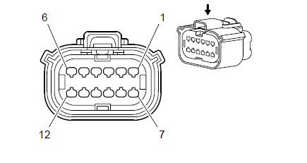

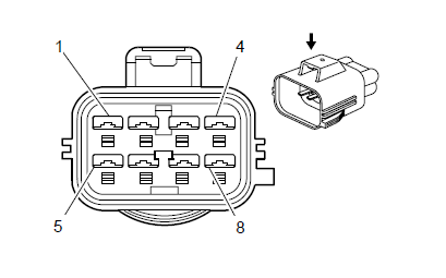

Search that document for "BRS" minus the quotes. That is the running board RPO option. You will get much more information. Where the power comes from (Connector X4, Pin G6 (30A Fuse) in the Underhood Fuse Block - Page 6-48), the ground goes to G420 (search that for a location diagram) - Page 6-85, and the Running Board Disable Signal (CKT 7462 (search "7462" to get more info on where this circuit goes) - you will find it comes out of connector for the dash switches (Page 6-836, Pin 8, you can check if this is populated in your truck - since it is an SLT I bet you it is there), and goes to X138 Connector (Body Harness to Chassis Harness). Look at pin 2 (Running Board Disable Signal) and pin 11 (low speed GMLAN Serial Data). That is what you need to get the module up and running. You truck did not have the BRS option so the chassis wiring harness will not have the wiring or the connectors to plug into the module. So you either need to make up your own custom harness from scratch (with all the connectors and pins and wire) for this or get a chassis harness from GM that has all the wiring for the BRS running boards already in it and strip the wiring out of the harness and adapt it to your truck. The Upfitter manual I was referencing to above is the 2019 Lite Duty Sierra Electrical manual: https://www.gmupfitter.com/files/media/photo/1162/19_sierra_1500_body_builder_Feb_20_19.pdf Xenawise- 138 replies

That in under the dash inside the truck, the running board control module is mounted to the frame of the running boards so that would be on the outside of the truck. So no, that connector is not for the running boards. I have no idea what that would be used for. Would have to look at a wiring diagram to even phantom a guess. Maybe the Trailer Brake Module? You would never see an exposed connector on the outside of the truck where water and such could get into the connector and start corrosion and other bad things. All connectors on the outside of the truck should be a sealed type to prevent water and oil from getting to the contacts. Xenawise- 138 replies

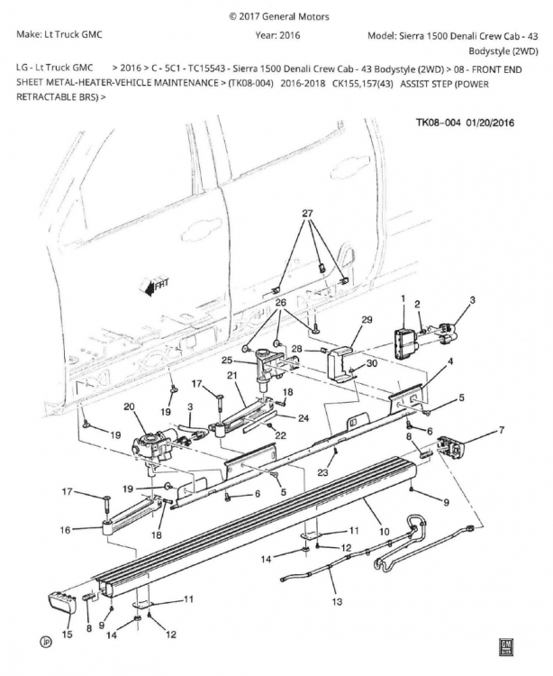

From the looks of the 2019 articulating running boards on a 2019 Denali, they look just like previous model so I would dare say mechanically they are probably the same. I believe the electronics in the 2019 is new, so the data bus is probably different so the running boards would need a new control box to talk to the 2019 data bus, and that would just require a new control module. Not sure if it physically is the same as the old control box, my guess would be it is. If not, then it would need a new retainer as well to match the new control box and mounting to the running board frame. The wiring harness would more or less be the same, differing in relation to the frame of the truck and how the routing over to the passenger running board is done. All in all, it should not be much different from the older running board setup, just have to keep in mind maybe a new control module would be needed as well as finding where the proper pins are in the truck harness to attach the data bus line as well as the running board disable line, if it even needs that any longer with the new control module. You would also need a new switch bar that would include the running board disable switch, and I bet your SLT will already have the wiring in-place to handle this. Just some opinions from having done this on my 2016 Denali. Good luck with the conversion! Xenawise -

You should be able to extend or retract the motors on the individual running boards by applying +12V and Ground to the thick gauge wires going to the connector on the running board. Don't connect to the module connectors, connect to the running board connectors. You will only see two thick gauge wires, those are the motor wires. The rest of the wires are for the sensors and kick switch. These thick gauge wires go to the motor and depending on the polarity you hook up, the motor will extend or retract. Hook +12V to one wire, and ground the other. The motor should work and the board will extend or retract. If it extends, then just reverse the wires to the connector and the motor will retract. Xenawise -

I would recommend that you open the door on the side you are going to remove so the steps come out. Then you can unplug the harness to the motor on that step and begin removing the bolts that hold it to the frame. These are pretty heavy so you will need to support the step as you remove it. It is much heavier on the front end of the steps where the motor assembly is. It is pretty easy to get all the bolts out. You will probably ship the boards if you sell them in the extended state as this will help prevent any damage to them. That is how they are shipped out from a GM dealer as well. The harness you detach from will stay with your truck. It is part of the main chassis harness and you cannot remove it (without a lot of difficulty). I think there were like a dozen bolts that hold the boards to the bottom of the cab. Some are higher up and go through the motor mountings and some are on the lower lip of the running board frame. Just make sure you support the boards so you don't damage them once they come loose from the cab. I think they weigh in around 60-70lbs per board. I suppose you are replacing these perhaps with some AMP boards? Are you looking to sell these take off boards? I might be interested if the price is right. Good luck with the removal and enjoy your new 2017 Denali! Regards, Xenawise Here is a parts book blow-up of the system. Does not show all of the mounting points but #19 and #26 are the main bolts. #4 is the frame that all these bolts will go through. -
