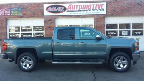

  1. Thanks for the compliments. The truck still rides very nice. A little noisy from the tires. I did not use rear shock extensions. They don't come in the kit and I'm not sure it it's really needed with the Rancho shocks. I do get some rubbing on the front upper control arms in a hard turn left. Basically a wheel lock turn will rub pretty good. These tires are very wide on the stock 20" rims. But there is no rubbing on the shocks, wheel wells or mud flaps. Fuel mileage around town had gone done a little. I also purchased the Diablo i1000 from Lew at www.diablewtune.com to correct the speedo and get a custom tune after I do the data logging. I'm happy with the way everything came out.
  2. 2014 Silverado LTZ Z71 & Rough Country 2.5" Leveling kit with 305/55/20 Nitto Dune tires Hey guys here is a video I made and some of the pictures of the Rough Country 2.5" Leveling kit install with 305/55/20 Nitto Dune tires I upgraded to. Stock 2014 Chevy Silverado LTZ Z71 with 275/55/20 Eagle SR-A tires. Stock ride height front Stock ride height rear Rough Country 2.5" Leveling kit Lower strut mount with 2" block Rear 2" block replaces the factory 1" block 305/55/22 Nitto Dune tires After ride height front After rear ride height After Now it looks like a truck.
