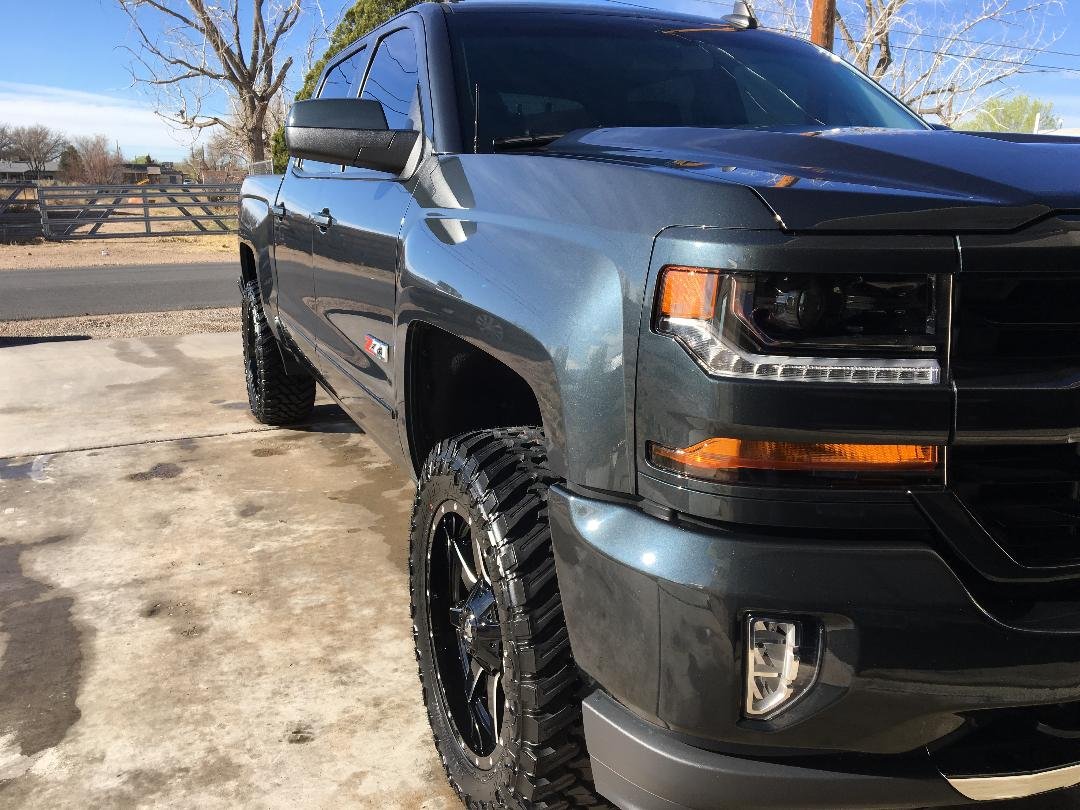

I have put 800 miles on the truck now. Still do not rub, full lock, turning, forward or reverse, slight incline etc. It might rub sometime off-roading or something but as of right now, nothing. I am very pleased with my set up!

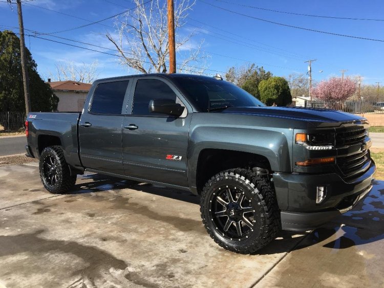

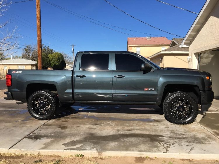

Mine is finally done! After months of research I went with the RC 2.5" level kit front only, stock rear block. 20"x9" Fuel Nutz w/ +1 offset, 33x12.50x20 Toyo M/T tires. No rubbing, No trimming, yet anyway. It is perfect for me. Just what I wanted.
That looks great! Do you have measurements? I am about to have my 2.5" level kit put on Thursday morning. The dealer wanted me to install the rear blocks but I think it will be too high in the rear. My stock measurements are 36" front 39" rear. So if I am thinking correct, 2.5" in the front will leave it 1/2" higher in the rear with the stock block.? But in your pics yours looks pretty level, just curious.
I just got done reading this thread AGAIN! Yes 2.5" with the stock block I should be pretty damn close to level. Now time to order my wheels and tires tomorrow!! Cant wait to get this done.
Ok, so I finally ordered the RC 2.5" level kit. My new wheels and tires will be next on Friday. From what I have read on here, if I just put the front level kit on and not the rear blocks, that will level the truck with no front higher or lower than the rear. Level. Am I correct in thinking this?
Your truck looks great! How much trimming did you have to do and where? Very curious I am going to order my wheels and tires today and if I can go with a 20x10 I will!
