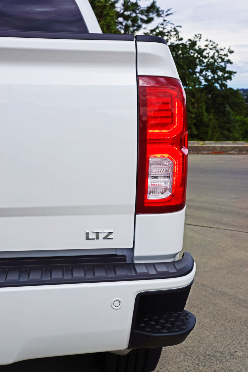

  2. The LED taillights will look like this (the reverse light is on the bottom): (I am selling a set along with the factory harnesses needed for the upgrade...You'd just need new resistors)

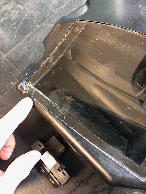

  16. I’m looking for some advice from anyone that has done this mod... I found a wrecker that has the HUD unit and switch. The problem is that there is some slight damage on the corner of the lens. My question is would this damage be visible once installed or cause any concerns with the image projection? Thanks for the help. ?
