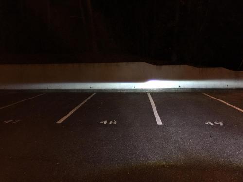

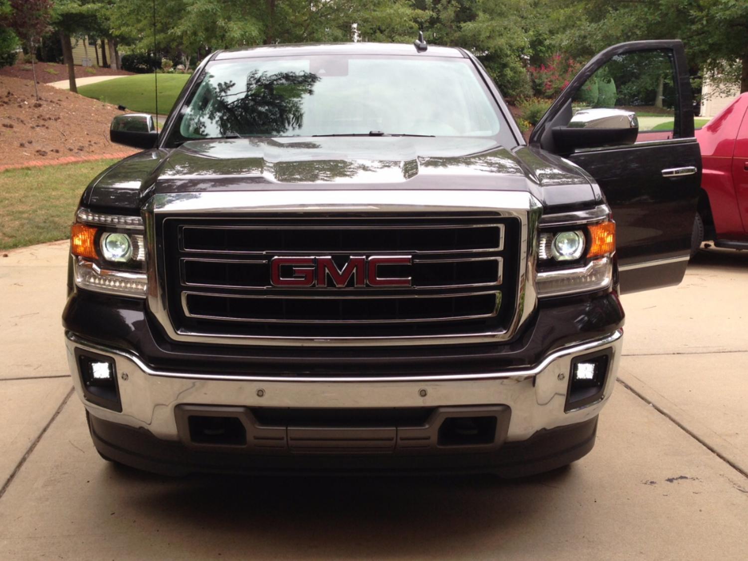

  1. Just aligning them on the wall. Install complete now. There is a manual in the silverado section on Fasheadlight.con. You can just use tape to reattached the housing or an Epoxy, whatever you feel. JB Weld is easy to work with and is rock solid. Great light output but you need some time and basic mechanical/electrical knowledge to get them in correctly and to hook up the high beams. Fun project.
  2. Rx350 retrofit and Rigid Fogs. Amp running boards.

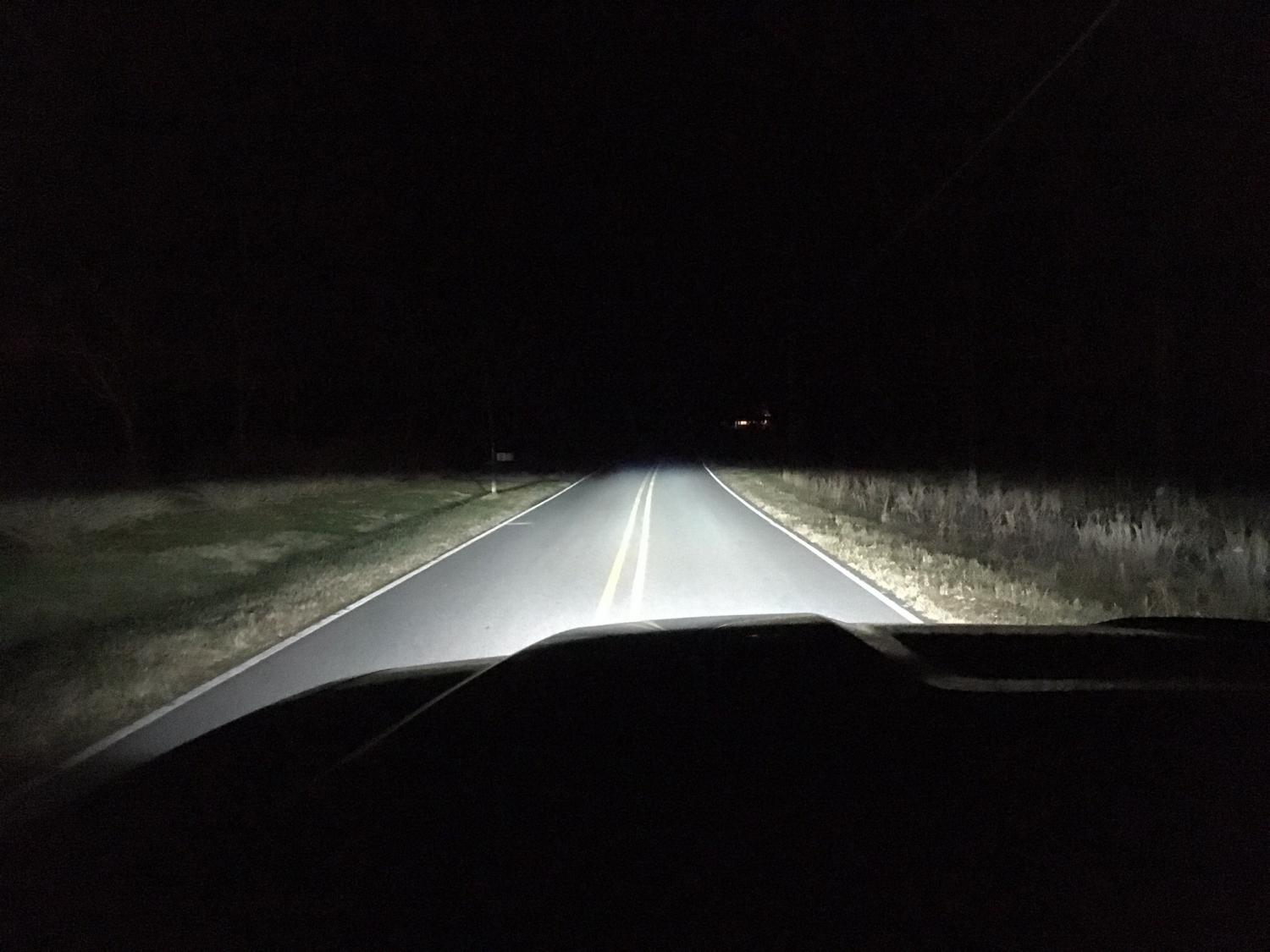

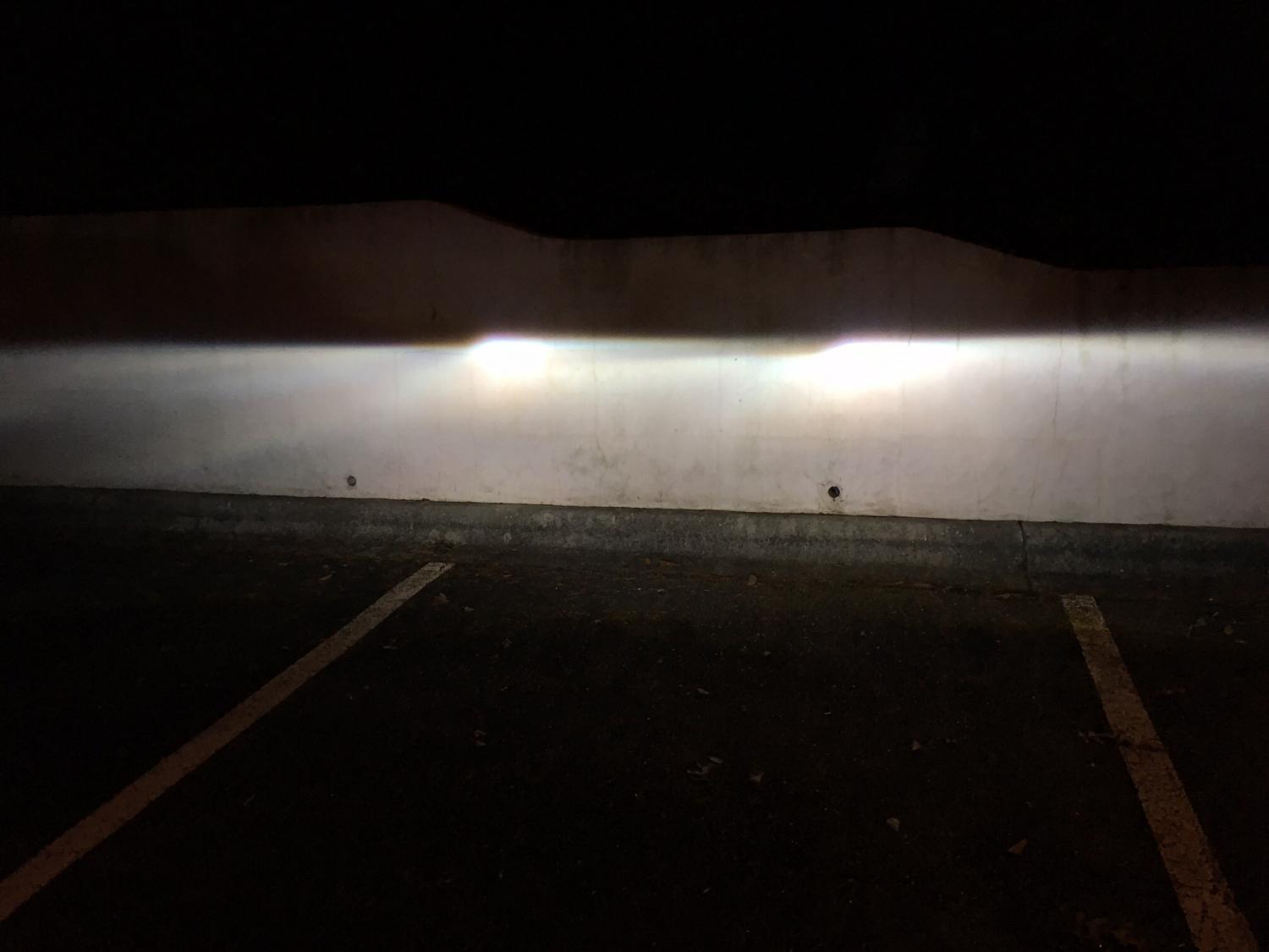

  3. Going through this now. I'm doing RX350s from Fastheadlights and opened it from the back side. Just cut the square part off and you have good access. I sealed it back with JB Weld and it's rock solid. Could sand it and paint for a cleaner look but no one sees it. HID projectors have a great beam pattern compared to stock w/HID. More light on the road less blinding. It is a job to do this but I enjoy tinkering and learning. The final product is nice too. I could not stand the uneven pattern of the oem projectors w/ HID. I wanted uniform proper lighting.
