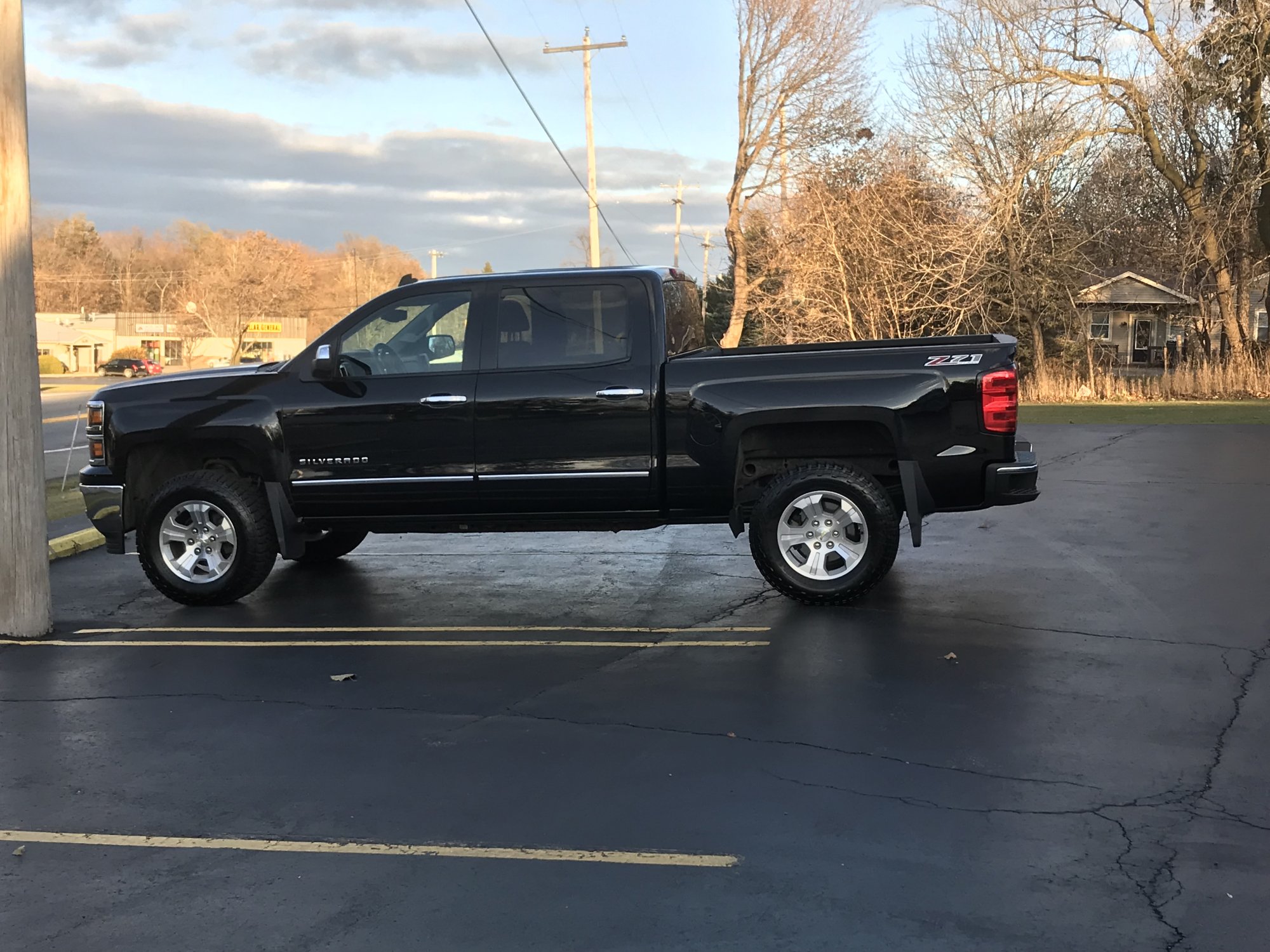

  1. 2.5' front 1' block in rear, 285/65/18
  2. I really like the Falkens so far, 285/65..

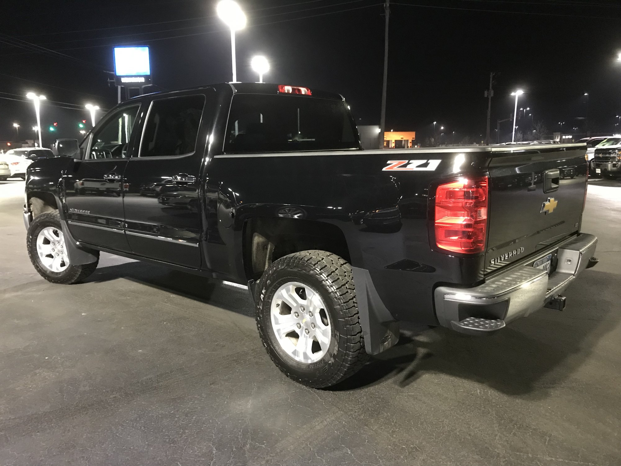

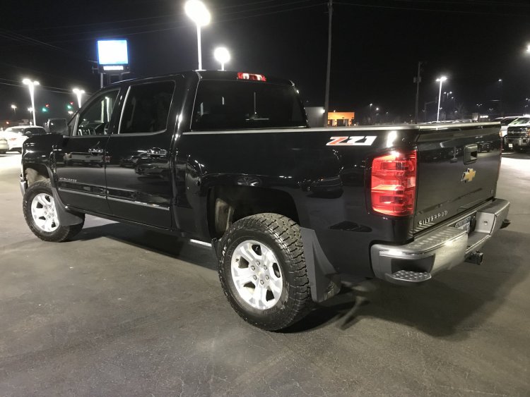

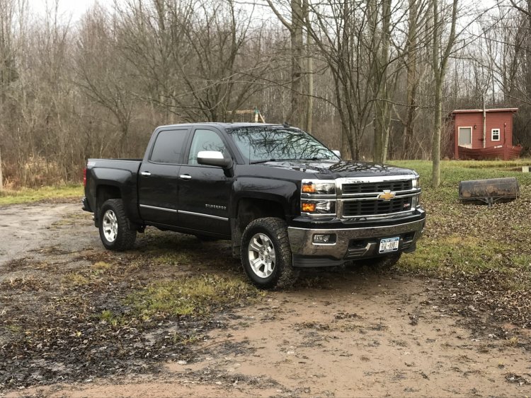

  3. 2014 Silvy Crew,_ Motofab 2 1/2 up front and Ebay 1" block in rear, Falken wildpeaks 285/65/18 , when i first started looking at the lifts seemed 2' had more rake than i liked so I compensated, bought a 2 1/2" up front, alot of pics on the NEW trucks seem pretty level however, on mine once installed then the back sat 1/2' lower..WHY because a 3 yr old truck with a seasoned suspension. So answered issue with 1' rear lift, to do it over i would of went with 2 or 2.25 front lift
  4. Did the Moto fab 2 1/2” front and 1” Lift in rear, Falken Wildpeaks 285/65
  5. Rear lift blocks question, I ordered a "true 2" lift" for the rear, assuming u stack it with OEM block, because I received 1"block, which I've read on here and now can't find it that guys don't prefer stacking the blocks..? Am I correct?? Also no instructions, believe the smaller width of block goes towards the front? Tks in advance
