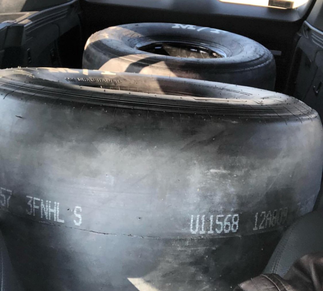

  3. I actually am about to take them off and run a 33x15x15 mt pro drag. I have a couple little things to finish then I’ll see what it can do

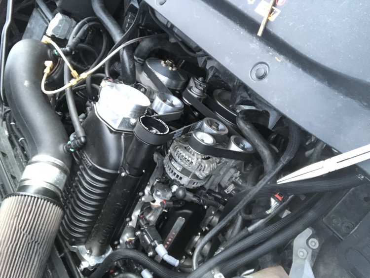

  4. Got the last pulley on ! My belt calculation was about an inch off I didn’t account for the iw pulleys being different than stock diameter to offset the 10% od on the balancer . All pulleys are aligned within .005”!!!!! I think I get to say I’m the very first 8 rib l86!!!!
  5. Ok I’m installIng the balancer today and pressing on the water pump pulley to the exact depth. On the two water pumps I have the pulley measures .6 “ from the back of the pulley to the face of the pump mounting /sealing surface. Should fire it up today but I had to order new stretch fit belts for the ac and vacuum pump
  6. And the water pump is a pain like the cars....
  7. Also the blower pulley I’m using is a 3.00 from weapon x that is designed for an lt4 ctsv with a whipple. Lines up well with the other pulleys , this idler needs spacing away from the whipple idler bracket it rubs against it
  8. I will say you will need an adp tool for the alternator, a three jaw balancer puller, and the water pump will use a standard three jaw puller and needs a press for installIng the new pulley. Removing the impeller/shaft/pulley from the housing is the only way to do it but it’s super easy if you notice there are 6 holes in the pulley which make it really easy to get to.
