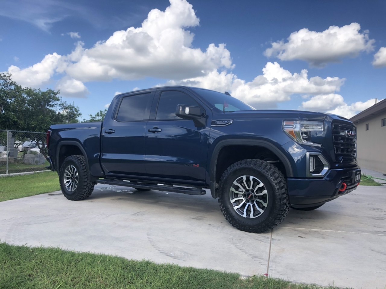

  9. Here you go....this is now with the level 1.5 and 295/70r18

  15. 1.5” motofab level Cooper Evolution MT 295/70 Zero rub Sent from my iPhone using Tapatalk
  16. Have been running motofab level for a year now on stock duratrac. Just installed 295/70 cooper evolution MT and they clear very well. They are 61.5 lbs which are pretty light compared to others in the same specs weighing on 70+....they measure 34.25”x12”....I could install a 1/4” or 3/8” wheel spacer but I think I will leave it like those for now. No rubbing on UCA so far all good. Sent from my iPhone using Tapatalk
