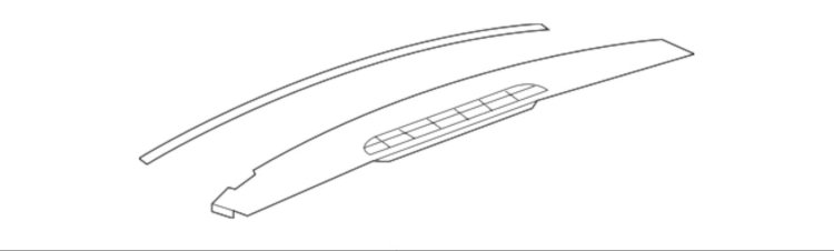

  12. Thanks, but I used GMpartsdirect which is where my first picture came from and couldn’t find where it attached to so I came here to ask all of you more experienced folks.

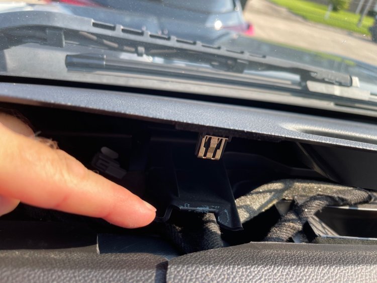

  13. Here they are. After I removed it again, I see where some are tied to the main dash itself, the other are a part of another plastic framing of some sort.
  14. My apologies for not being precise as I’m not in need of the clips. When you remove the panel, you can see into the dash and where those clips would sit when the trim is reinstalled. Some of those locations are missing so the clips have no where to hold it to the dash. I’m looking to see if that’s a part that can also be replaced.
  15. I like many have the cracked dash on my recently purchased ‘11 Silverado. While removing the Instrument Panel Extension Trim Panel to see why it didn’t seem to be sitting correctly, I noticed the frame? It attaches to with clips was also missing some of the slots for the clips to sit in. Does anyone know what this frame is, how easy/hard to replace, or other options to repair?
