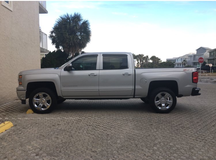

  1. Agree it should come that way. I worked to find the best combo Of above factory while keeping factory ride. Accomplished both with 2” under strut only TGC level kit and 2.25” block in the rear. Love the slight height difference from stock.
  2. Got it from an off road store. Yes it’s a Readylift 2.25” block, which the salesperson referred to as a plus one.
  3. I had an add a leaf from a different company that was very good. It raised the rear 1 1/4”. FYI, the front had a TGC 2.5” level in this pic. I eventually went to a 2” level and 1” rear block because I didn’t like the loss of factory ride and decreased range level of travel in the front at 2.5”. The increased clearance I ended up with is exactly what I wanted and I’m happy with the setup with the bigger LTZ stock wheels and tires.
  4. After installing a Top Gun Customz 2.5” front level and an add a leaf in the rear, I’m taking the front back down to only 1” today. Reason is the ride up front bangs around more than I like for a truck with only 22k, and I believe GMC-AT who’s tried many level combos and recommends not going over 1.5” (and doing so only with under strut plates). If the rake is too much I’ll also remove the add a leaf but I’m about to haul a 4K lb trailer 1000 mi so I may hold off on the add a leaf removal. I really like the stance but the ride and other guys’ issues with ball joints and other wear have pointed me toward a Zone 1.5” body lift—if I want to get back to this look after removing most of the front leveling kit. Anyone else have ride quality issues resolved by using less of a leveling kit?

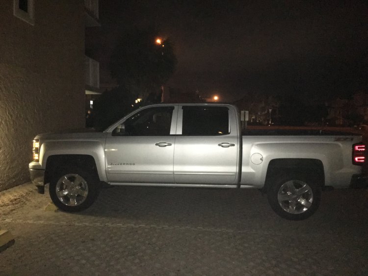

  5. All stock with 2.5” TG Customz level in front and add a leaf in rear. Minor issue: some banging up front on rough roads, which I think is due to UCA hitting metal stop lightly. May remove 1.5” of the level and go to 1.5” zone body lift but the rake might require the add a leaf to come off.
  6. Sent you a message about level recommendations from the “consequences of a 1.5” level” article about two years ago. Would appreciate your input.
  7. I have a 2015 Z71 Crew with the Top Gun 2.5" leveling kit, and it's been aligned since install. I also have an add a leaf on the rear, but all else is standard. The rake and height are perfect, IMHO, but on uneven pavement there's an annoying noise up front coming from what I'm pretty sure is the struts. The TG kit has two leveling plates on bottom and one ring on top of the strut to get the full 2.5". I've also done the 1.5" version with one plate on bottom and the ring and had approximately the same noises from the strut. Do you think I'd lose the noise if I only do the plates on bottom (only one set of plates and no ring, which would be only a 1" front level)? I think I'll then have to remove the add a leaf and do a zone 1.5" body lift to get back to where I am. But I want the factory ride back.
