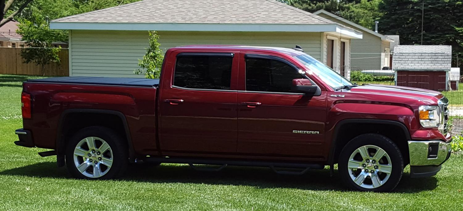

Was either this or a stone blue metallic. Both very nice when cleaned up. 20 years between owning a burgundy colored vehicle with whites and silvers in between and they just dont shine like this does.
