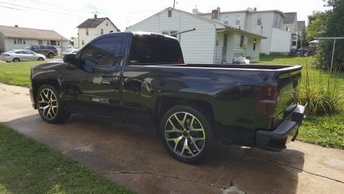

  1. current setup after bringing the rear down another inch.
  2. I'll try and do some launches from a stop on my way home from work today, and check out how it feels. But as for normal driving(bumps, potholes, dips, etc.) seems to be working very well. No complaints.
  3. Just to inform of my findings. To get that last inch I desired on my McGaughys rear flip kit, I was able to use their GM short shackle. This was used in conjunction with their adjustable spring hanger. This will get you back the inch you lose when you trade out your stock hanger and use theirs. I have put 180 miles on this new setup and it rides perfectly. No binding, clunking, or squeeking. The shackles clear the spring and the hanger just fine. Ride quality is great, no change from stock shackles. Others might have a problem if you still have your stock hangers equipped. These shackles are specifically designed to work paired to their adjustable hangers. All in all, if your looking for maximum drop from your flip kit, just leave your stock hangers on. Looking back, that's what I should have done. Now the truck is sitting exactly where I wanted it to be.

  8. Used their hanger, and bolted it at the highest setting, for the most drop. Had to fold over the pinch weld on the bottom of the bed to mount it up. This should have been a 6" drop, which it very well may have been.(I didnt take fender measurements before I did the drop) But I'm looking for one more inch.

  11. I used McGuaghys flip kit, with their lift hanger, and stock shackles. Lift hanger set to the highest setting(for most drop). This is supposed to achieve 6" of drop. If I would have kept my stock hangers, then I would have yielded 7" of drop. So now, Im going with McGuaghys shackle designed for their flip kit with lift hanger for another 1" of drop, putting me down to 7". Which would be opposite of what you would need to lower, if you havent done a flip and lift hanger
  12. To clear everything up: If you have used McGuaghys flip kit, with lift hanger, then you need shorter(lift) shackles to achieve a drop in suspension. Like in this link: https://switchsuspension.com/gmc-sierra-1500-2014-2018-rear-1-drop-shackles-mcgaughys-part-34040/ If you have not used a rear flip kit, then you would need a longer(lowering) shackle to achieve a drop in suspension. Like in this link: https://switchsuspension.com/chevrolet-silverado-1500-2014-2018-rear-1-2-drop-shackles-mcgaughys-part-33037/
  13. since my shackle is running pretty much vertical, I would need an 1" shorter shackle to achieve what I want. Which brings us into the lowering/lift shackle debate after flipping. I think the lowering shackle would actually cause lift in this application. I think this is what I'm looking for? Since I'm running the lift hanger from McGaughys. The other "lowering shackles" out on the market look to be much longer, which would cause lift. https://switchsuspension.com/gmc-sierra-1500-2014-2018-rear-1-drop-shackles-mcgaughys-part-34040/
  14. Sorry, looks like after reading back through this thread, if I wanted even a lower drop in the back, I should have stayed with my stock hangers. I'm wondering if a shackle will get me my 1'' I'm looking for. Anyone run that kind of setup?
