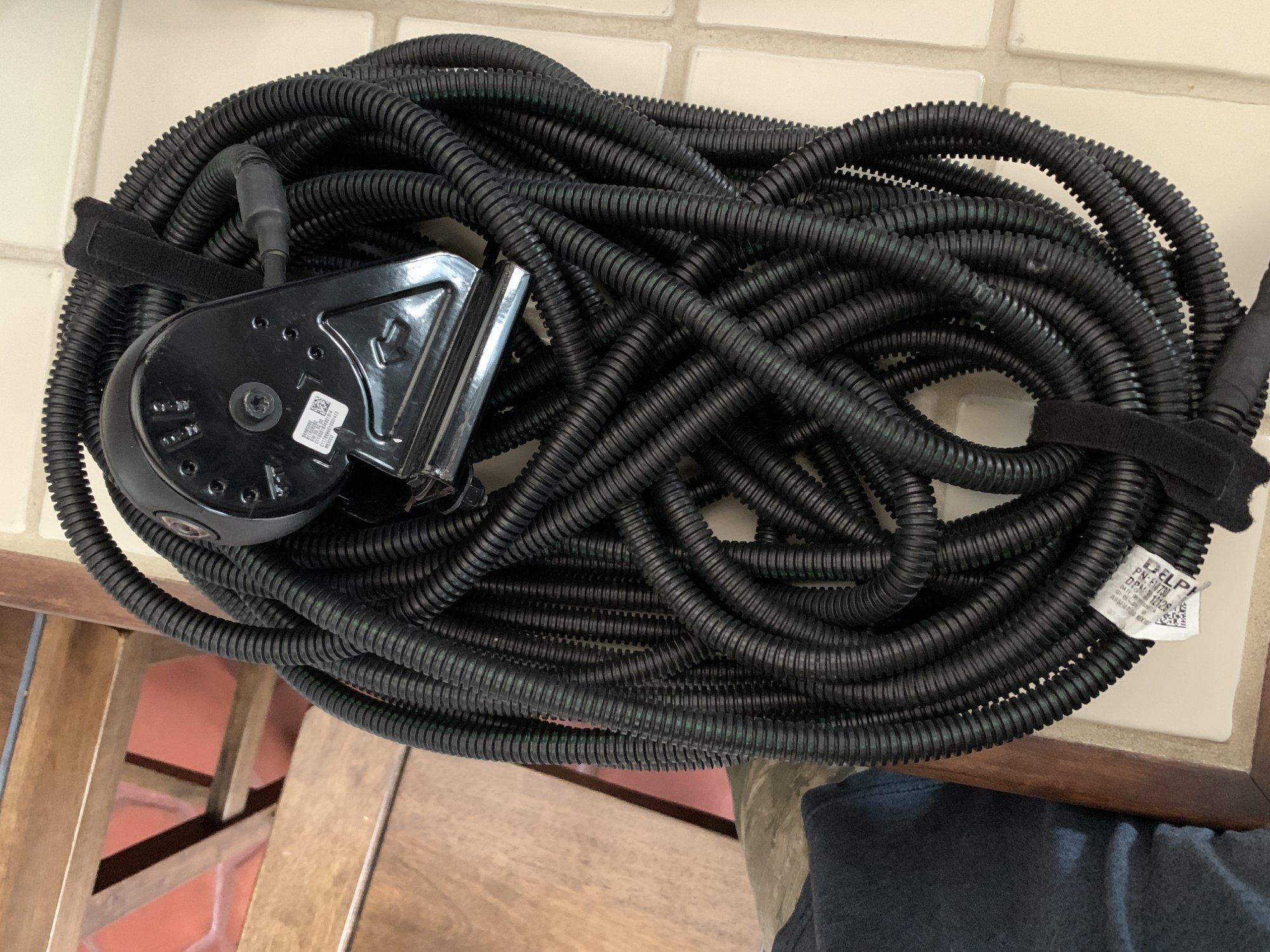

  6. Hi All, The camera pictured was sold last week. Thanks.
  7. It works great. I mounted it too high on the trailer for the invisible trailer feature but for backing up or seeing behind the trailer its great.
  8. Hi All, I have one of these 84580657 that I used for a couple of months on my 2020 Denali HD 2500 that I can get rid of. Ill sell for $285 plus shipping which would be a large flat rate box (if I can get it to fit) which is $21.10. You would need to buy the mounting clips and zip ties as they went with the trailer.

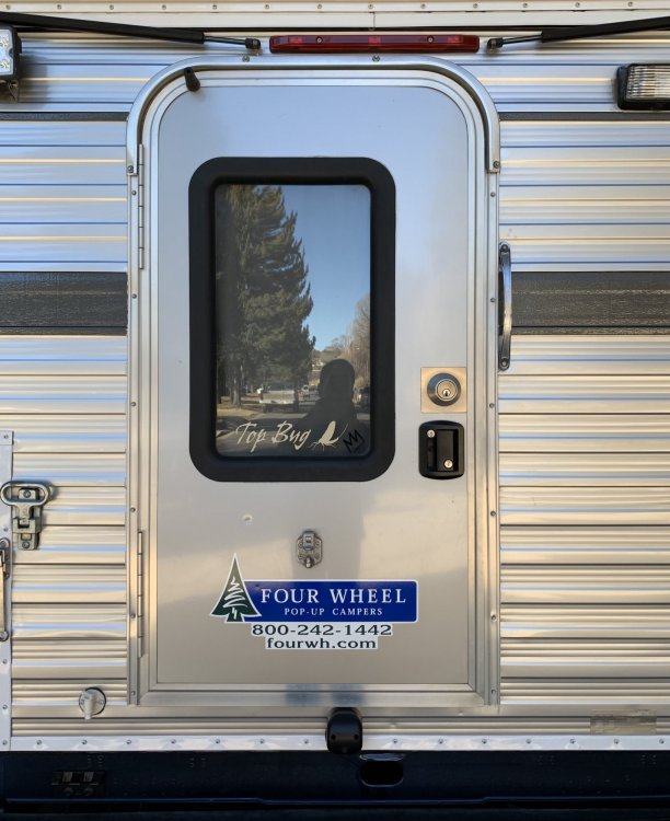

  12. Its mounted just below the door of a Four Wheel Camper.

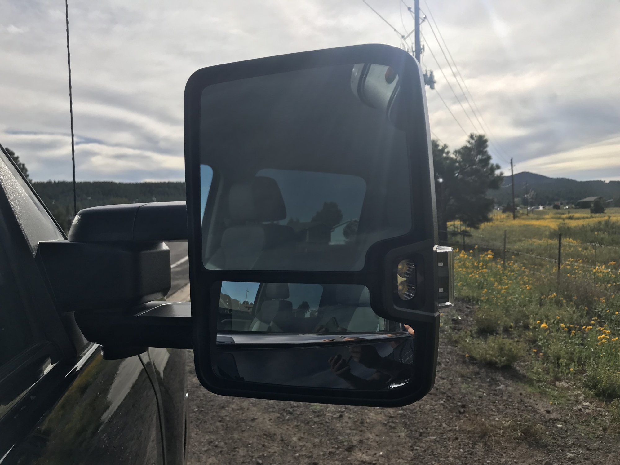

  19. Once again Phil is the man. Ordered his plug and play harness for the 1A Auto 1798 mirrors which are the 1786 but with the passenger sensor for the Duramax diesels. Ordered and received within 5 days, followed his instructions and videos. Took about an hour for the first side and about 15 minutes for the other once I knew what to expect. The final product is pimp daddy and complements the truck well and has every bell and whistle. Phil was available for any questions and super responsive. He IS the go to for this application.
