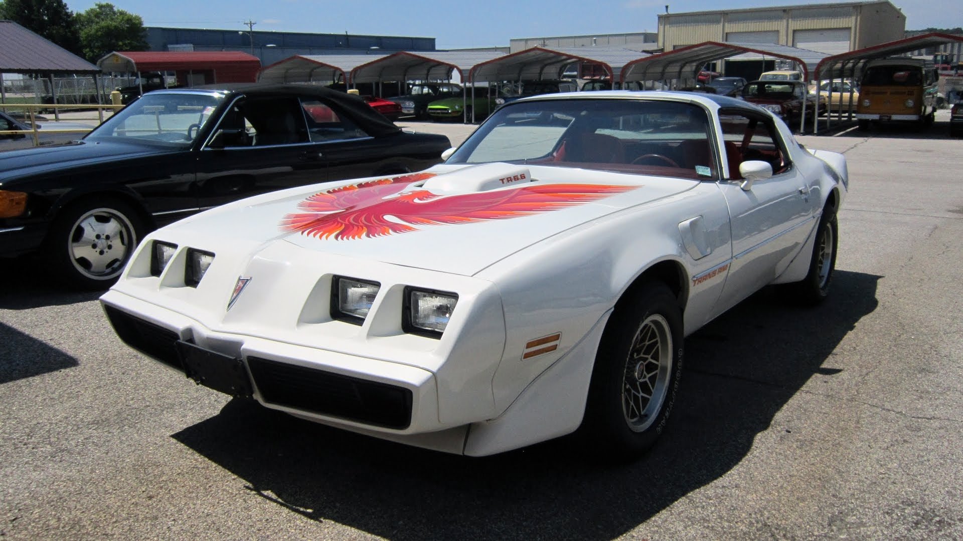

@JimCost2014 The term you're looking for is Rally Gauge pack and it usually came with the Formula steering wheel. This is a link to my current resto: https://flic.kr/s/aHsmhNR4hF I had a full write up on this car but there was a catastrophic server failure at the site I was using and it's been lost; I wasn't smart enough to make my own backup. It's a 1979 Formula that a previous owner changed to a T/A. I bought this to kick around in while building the '72. I knew it was POS and I was just gonna beat the balls out of it and then part it out. BUT I accidently started restoring it instead. Honestly, it started with one quick fix and the next thing I knew it was stripped and I was welding in new steel. When finished it will be a white TA with red interior and red graphics. The pic below is what I'm aiming for.

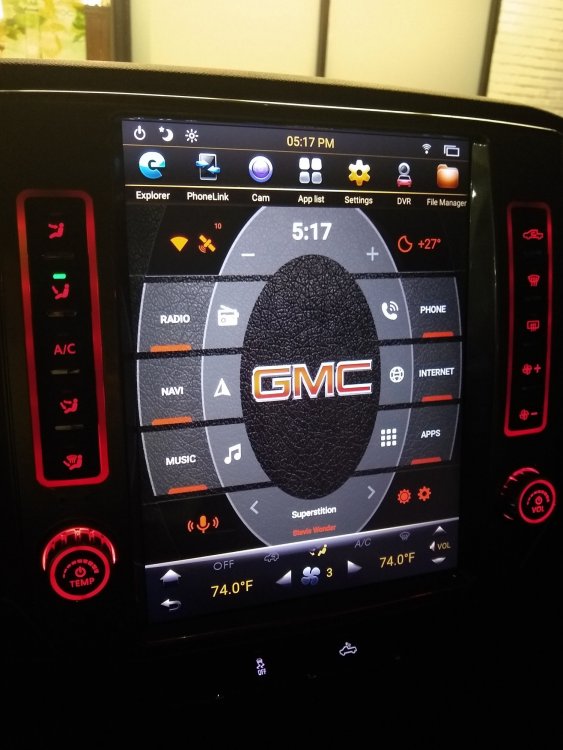

@lectrician7, I just tried Waze. WOW, it's pretty great. Thanks for giving me a reason to try it. On my unit, I can only get voice directions on any nav app if I'm using a music player. When I use Console, it will not release audio focus for the nav app. I've had good luck with using split screen for nav and music players but it takes some practice to do it while driving. As a side note, the lag issues went away. A reboot may have fixed the issues. I got a funny feeling that they'll be back. @g2full -Most android head units are consumer grade and that's reflected in the price. A lot of what you're buying with these particular units is the system integration and the huge screen. These units are lack-luster but do not judge all Android head units by this one. Some are better than others. For the cost, I wish I invested in one of the smaller, cheaper units with an independent stereo attached that did not integrate with the GM systems. The big issue you run into with Android based units is that the bezels never fit perfectly without a little modification. -Most of the climate controls are not on the screen, on these units. We have hard buttons and a knob. Lag time is with the displaying of the climate settings change, not the control of it. Ironically, this is reversed with the volume controls. It will lag in turning it up or down in both control and display. As discussed, this may have been caused by using alternate launchers. -Boot time is horrendous at about 40-50 seconds, I can confirm this. The unit will only need to be rebooted if your vehicle hasn't been started in 2 days. -The volume switch doesn't bother me and, I swear I'm not sticking up the guy that came up with idea because I think it's silly too but, the heat knob on the left is working out for me very well. I always end up playing with it a lot when on a long trip. I also play with the home thermostat a lot too, LOL. I was planning on using a remote like the one in the pic below. Now, I may have a chance to get my steering wheel controls to work. Either way, I will not be trying to get any remotes to work until I have a functional head unit. ***At this time, I do not recommend these units to anyone. I purchased mine because I'm a tech geek and can handle playing around with them. Also, I can technically afford the hit should I turn the unit into a brick or maybe, a clay pigeon. I have a WT with I03. My opinion for people looking to upgrade would be to look into the Alpine 110x/i209 or an MVI upgrade. If you're on a budget or like me, just plain cheap, then a $200-300 Joying unit would be an ok choice. -

Lectrician, sounds like you already have the upgraded Maps. The version mine comes with still has the robotic voice but works well. When I update it to get the modern voice, then I get the green bar. Other than the green bar taking up a bunch of space and the search bar being a few inches too low Maps technically works. I've had occasional issues with voice guidance on Here and Maps. I think it comes down to the audio focus of the unit. I'll give Wazes a shot and report back what happens. I've heard good things about it from others but never tried it cause I was a big fan of Scout and had Maps as a fallback. I bought my unit from Kirinavi, a reseller, but it's a Phoeinix 7.1 fast boot. Kirinavi's engineers have been trying to help but there's the language barrier. They told me to go Pheoinex for an exchange; I'll reach out to them later today. There was a 30 day money back guarantee on the unit but I'm way past that. I can deal with software issues but the climate control buttons not working is a total deal breaker and now I want an exchange. I did the Phoeinix MCU upgrade but it did not fix my off center issue. I've tried 3 launchers now. So that's probably why I'm having so many issue with lagging. Have you checked out XDA Developers? It's an Android modding site. There are people out there ironing the bugs out of these units. There is a way to reset audio focus and to reassign the top bar icons. Unfortunately, a lot of the info is from a Russian site and I only got a C in high school programming so I don't know how far I'll go down that avenue. I did have Google voice working but it was SLOW! It allowed me to make calls, search the net and choose music through voice commands. I thought I was all set when I found the Agama launcher because it put EVERYTHING on a single page. I have the same issue with wi-fi but only when the device reboots. I have mine set to stay on for 48 hours. -

Lectrician7, that's the Agama car launcher. It's on the Google Play store. https://play.google.com/store/apps/details?id=altergames.carlauncher The logo in the middle can be several things from a compass to a clock and even an info center for other apps. I had to change the theme and colors a little to make it look like that but it was real easy. To be 100% clear, neither this launcher or any other launcher I've tried on my device works correctly. I've never used Waze. I can tell you that the Google maps that ships with the device works fine. The problems start when you upgrade the old Maps and the new Maps will not scale correctly. It works but the upper green bar is way bigger than it should be. I use the default Here nav app and it so far it works great. Did your unit come in a box marketed as a Phoeinx device? Is it the fast boot 7.1 model? There are only 2 or 3 manufacturers and many, many sellers. Some of them come with android 4 and others android 7. ***READ THIS PART*** My unit has become useless in the last week. The lag times on the volume are getting to be around 30 seconds. I had this issue when I first installed the unit. I pulled it out and THOUGHT the issue was caused by a loose wire connector. The climate control lags too but only on the display changes; for actual function there is no lag. About a week ago the issues came back. I checked the wires and they are all tight. Another issue is that the upper left climate button doesn't work anymore and it seems like the second button down is starting to have an issue. Yet another issue, is that the device will not release audio focus from the Console. So what that means is when I switch from Console to Music the radio continues to play. An issue I had from the start is that when in Console mode the factory emulated screen is off center. The seller told me I had to run through all the parameters in one of the menus and find the right one. I've been through that twice now. The seller isn't terrible helpful, so far. Their engineers have been on vacation for the last few weeks. I MIGHT hear something from them on Monday. Are you having issues with your unit? Is your truck I03? Please let me know. Are your issues only with Waze? At this point, I can't decide if I want to push for an exchange for another unit or a total refund. I'm not sure how far I'll get with either one. -
