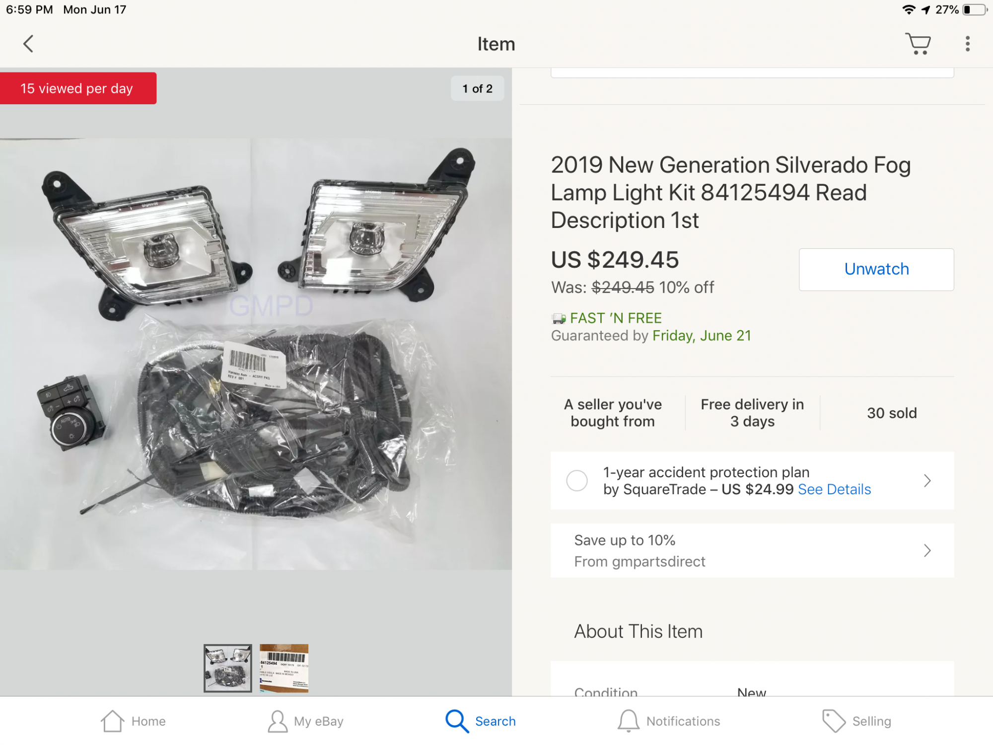

  22. Here is where I got mine the description then next pic is seller info
  23. This is a gym kit so everything comes with the kit here is the switch
  24. Now with the factory fog lights they are not to bad to put in until you get to the fuse block under the hood that takes some time. The wire that goes to under the dash to the fuse block was the hardest for me. Light switch wasn’t bad just take your time. Then you find a dealer that’s up on flashing the computer to let them work. One dealer 1.5 hours away that was recommended said 1 hour they do them all the time. My dealer 4 hours to get them to work should have driven. Ask around talk to them they should be able to give you a price to flash or install.
  25. Yes these are factory fog lights there is a Chevy dealer on eBay selling them for customs 245 delivered
