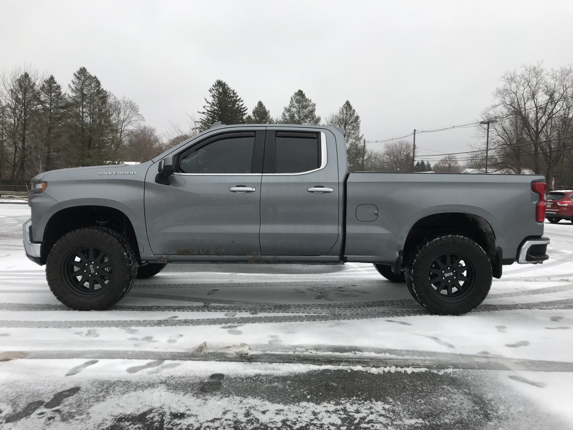

  2. I went to the dealer to purchase the trail boss cb axles but they wanted like 800 bucks. Just found them last night on GM parts outlet for like 100-140 if I remember correctly. I’ll probably go that route down the road just to be safe. As of now with my 4” SST the 4wd works without any issues/noises.
  3. Black Rhino Stadiums 20x9.5 -18 4.5 backspace. Hub centric rings from 78.1-112.1mm Tire size 295/65/20. Lift Ready Lift 4” SST

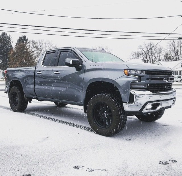

  5. Installed a 4” SST Kit with Black Rhino Stadium 20x9.5 -18 offset wheels wrapped in 295/65/20’s on the LTZ.

  7. Just installed these Black Rhino Stadiums. They are Rotary Forged, super light. 20x9.5 with -18 offset with Hub Centric Rings 78.1/112.1 SUPER close to the caliper, a little too close for my comfort. Wondering if I should purchase hub centric spacers.

  11. Looks awesome what size lift/tires do you have on it? Also what’s the wheel offset?

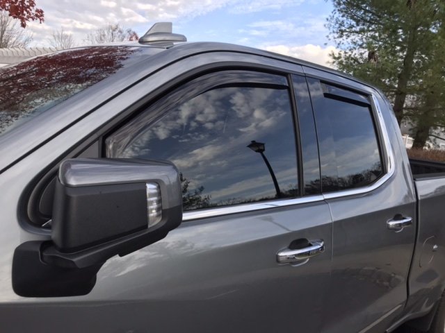

  18. Order and installed the EGR dark smoke window deflectors. Used my GM points rewards so total cost was $9.23 which isn’t bad! These kinda threw me off for a minute, I was expecting the front ones to have double sided tape on them but they don’t. Only the rear deflectors have tape on them. Simple install, took longer to clean the seals! Nice and sleek, they are flush with the trim.
