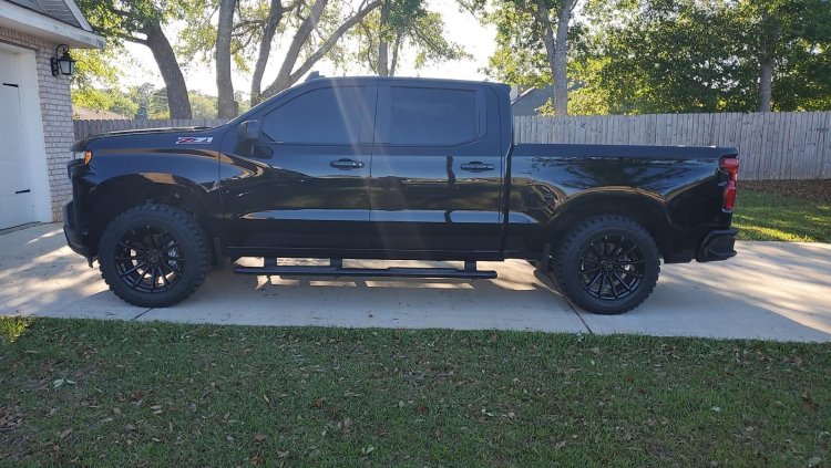

  1. short answer , NO. the width is going to be he issue. the sidewall will come in contact with with the upper control arm with a 12.50 wide tire. A 35 will fit but try and run a narrower tire so you dont have to run wheel spacers .

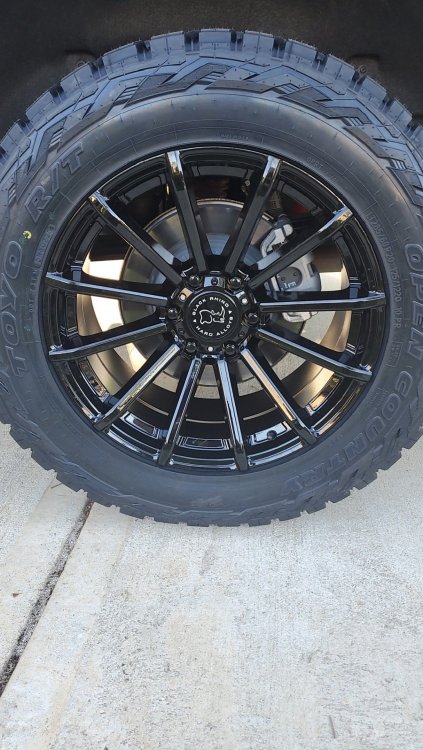

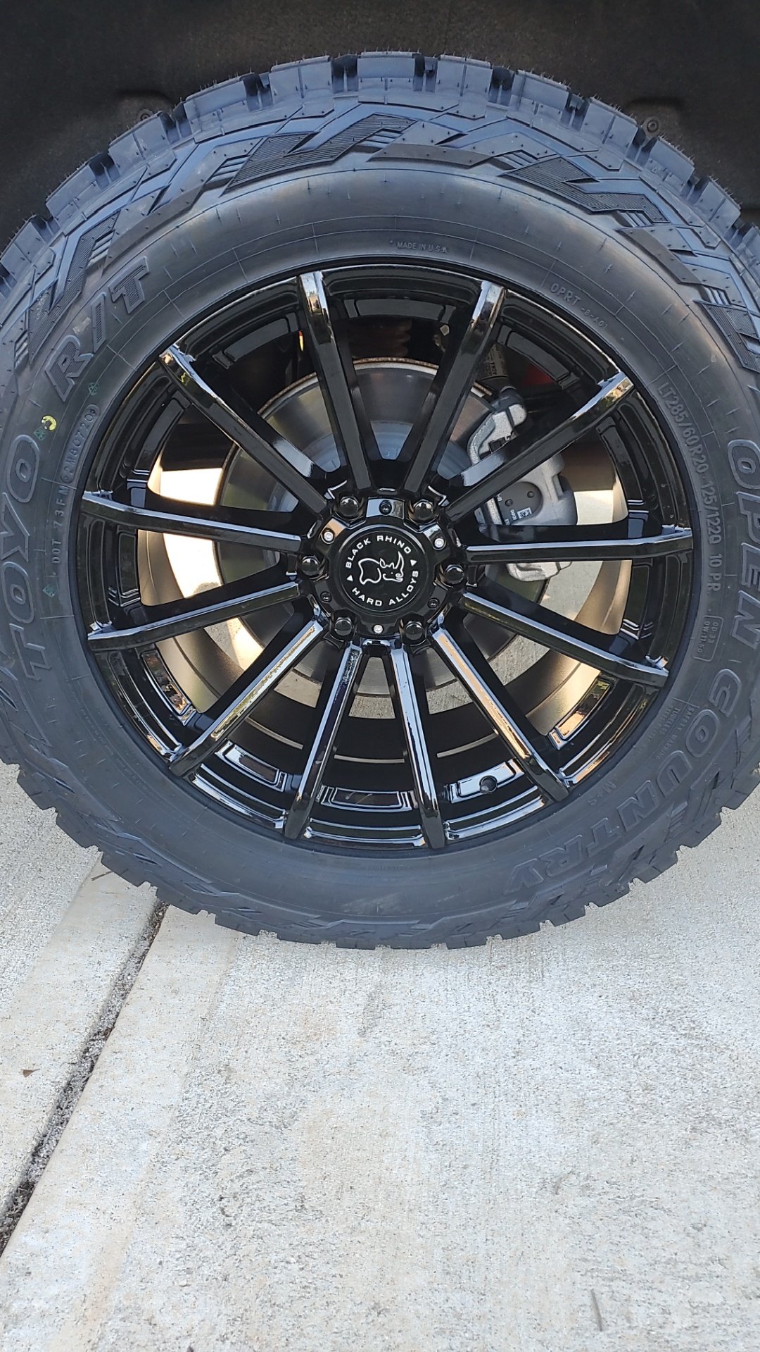

  3. Was there ever any clarification on these wheels, cause im definitely a fan. OEM or replicas? 22s it looks like. any additional info would be appreciated

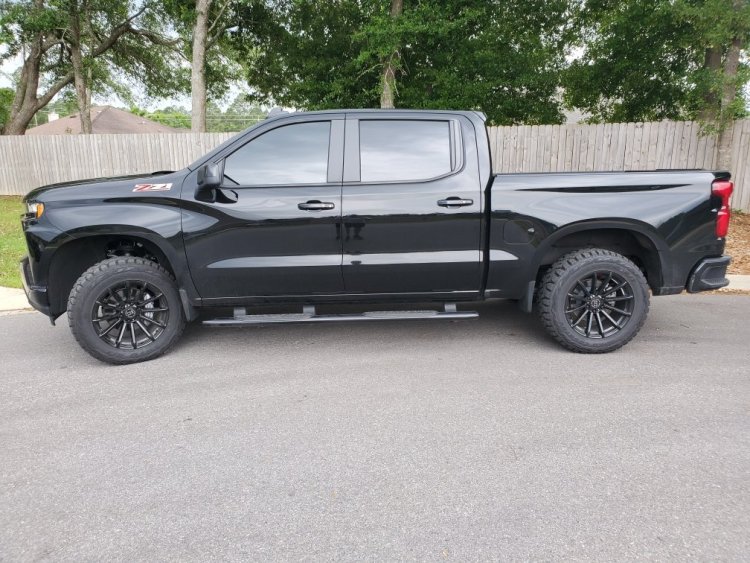

  4. More photos please! Looks good though! I have the 2 inch Zone Off-road top spacer sitting in the garage waiting to go in just need a day off to do it !
  5. Couldn't agree more. A small wheel spacer will fix the rubbing on the UCA! Post more pics of the truck. Happy to see someone running 35s leveled.

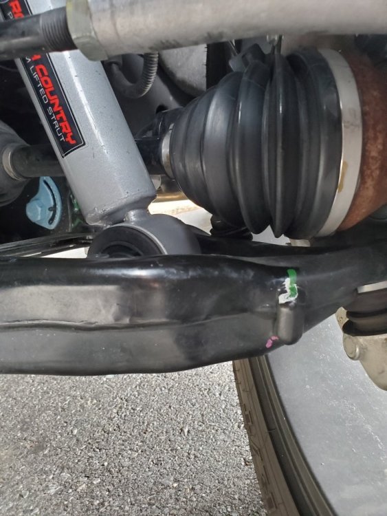

  6. Yes as stated in the caption it is the Rough Country leveling struts they offer. 2 inch lift struts. Approximately $325 for both I believe.

  8. First photo (side view truck has the 2 inch Readylift) since been removed cause the boot contacted the bottom part of the strut. Added Rough country 2 inch leveling struts and the Readylift was removed. Plenty of cv axle clearance now . 20x9.5 on 285/60/r20. It’s my vets truck. He said no rubbing and rides a lot better than factory.
  9. Looks good, CV angles aren’t bad but what I can’t see and is my concern is how close the bottom of the boot is to the lower strut. I know that Readylift has issues with the 2 inch kit. The 2 inch will contact the boot. Helped my Veterinarian who’s a close friend remove that 2 inch kit cause of that reason

  14. 275/65/r20 will fit without any rubbing with a 2 inch level. Regardless of which level. The demo I drove while my dealer did my bed liner had the GM 2 inch level installed on a RST model with 275/65/r20 BFG all terrains. Plenty of clearance. 35x11.50s would clear in my opinion
