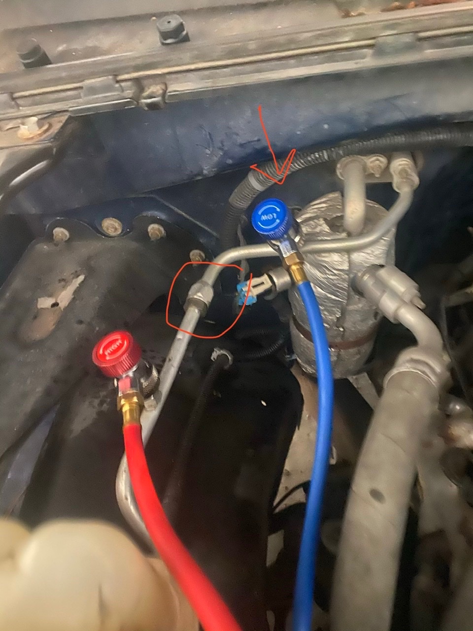

  14. Had to drive it last night. Hooked everything back up today and it vaccum a down to just shy of 25bar. After sitting for 1.75 hours, if it’s moved it’s barely lowered. so I guess I’m good to go? Run the vaccum for an hour and recharge?
  15. My uv light indicated I needed to replace this flared nut seal, and the low side valve was gurgling bubbles too. Both replaced and I can vacuum it to 25bar. After about 30-45mij it drops to 20bar. i haven’t found any more dye, but haven’t started digging in deep. Any thoughts on where some likely spots are before I go on a goose chase?
