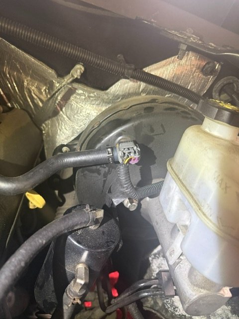

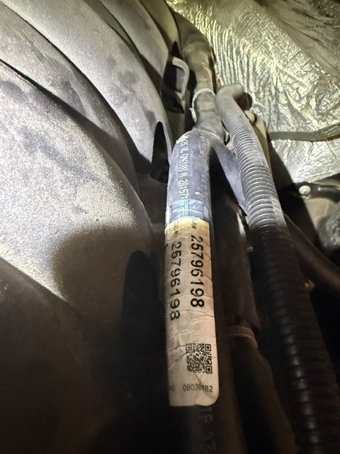

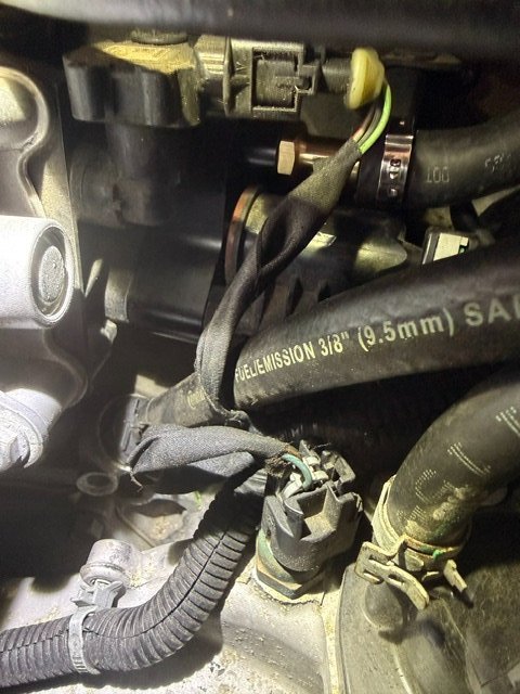

  1. Just thought i'd add how i did this delete with my truck. Better late than never I suppose. I purchased the PnP Tech Works Vacuum delete manifold (Vacuum Pump Delete Manifold - OEM Fitting – PnP Tech Works) which is just a spacer/adapter for the EGR w/ an added vacuum port. I have a catch can but I didn't want to tee off any fittings in case i were to need to remove it for whatever reason. PnP has a hose you can buy, but i found GM Delco 1761488 (25796198) per recommendation I saw in another thread. The factory hose clamps i felt were a little too loose so I used my own hose clamps (crimp style). you can scavenge both vacuum ends but i only used the brake booster side. Having 4wd, removing the bolts were a pain. I found the rear 2 bolts were easiest underneath using a u-joint socket adapter to rotate close to 90 deg and a bunch of extensions from underneath. May have made the other two bolts easier but I had them out by then. I have a 6.2 manifold. top of picture show hose barb with hose attached I rotated it back downward after this picture was taken as they were taken before I crimped the clamps.

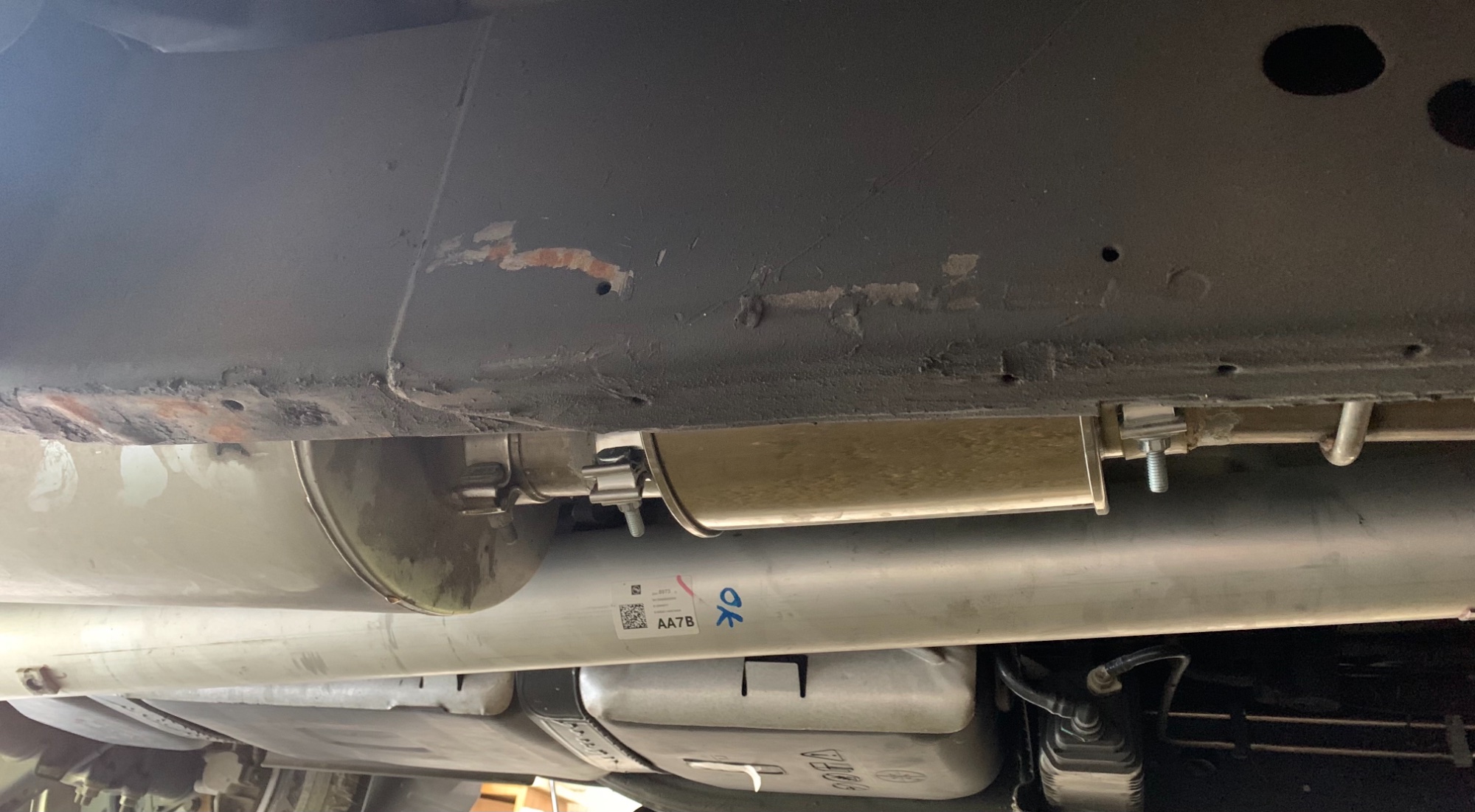

  8. If you have long tubes and cats are removed these trucks are very raspy. I do miss the crazy loud cold start/idle, but driving around was obnoxious. Adding the vibrant ultra quiet resonator fixed it for me. if your turn down is ahead of the axle you may not have much room to work with to fit both a muffler and resonator.

  14. Ultra Quiet. Check my latest posts in another thread I uploaded cold start from before vs now. Exhaust is nice and quiet at cruising speeds but still sounds good when into the throttle. Don’t miss the rasp and now I think it was a good decision.
  15. Yes. As for the previous post. I don’t think there is any room after exhaust. Im sure I could’ve just removed the tip and bolted to exit to test it out beforehand though. After having it on I definitely don’t miss those loud rasps between shifts. Its essentially back to how it was designed by Corsa, nice and subtle cruising on the highway and loud when you get on the throttle….vs just loud and obnoxious all the time before.
