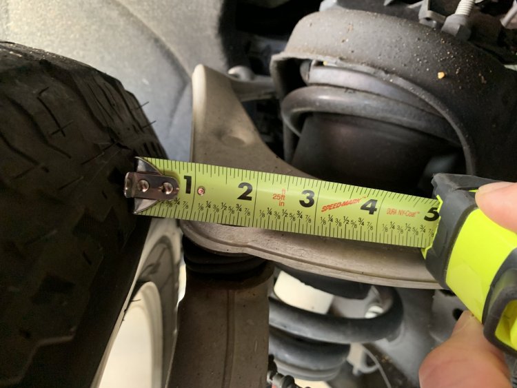

  13. With my 2 inch level, my 275/60R20 Revo 3's, are already only half an inch or so from the UCA. 285/60R20 KO2s will fit with absolutely no problem, my buddy is running those on his leveled truck, and they are 33.5 x 11.2 on their spec sheet, again the factory Revo 3's are nominally 33 x 10.8. I don't see how you can run anything wider than the 11.5ish on OEM 28mm offset wheels without spacers. Here's a photo of how close the 275/60R20 Revo 3's are to the UCA at full lock.
