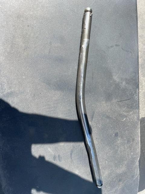

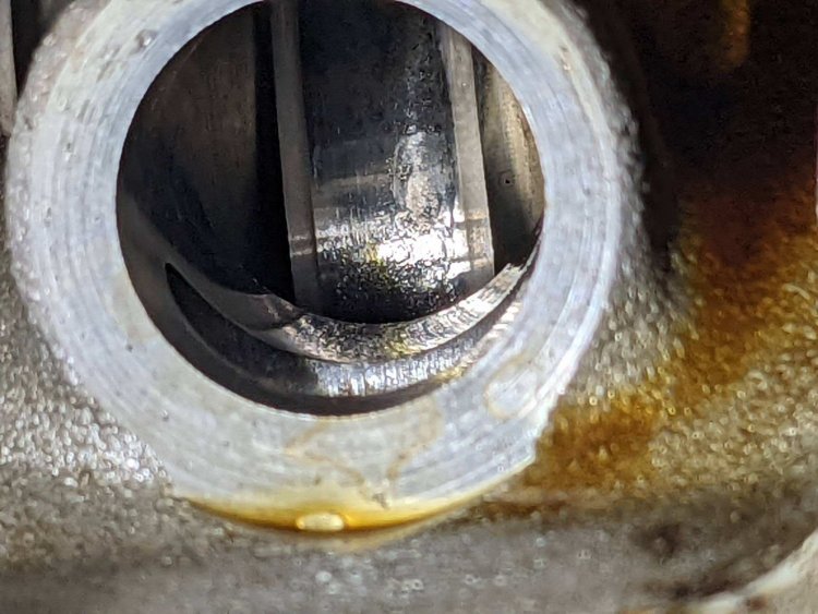

  1. I was not able to ever pin point where it was coming from. Even with a mechanic stethoscope the trick always sounding the same everywhere around the engine. But the common ones I had checked for were: *Any injectors louder than the others *High pressure fuel pump area *Approx location of each cylinder on the valve cover *fuel feed hose that goes into the high pressure fuel pump (supposedly a check valve in there that can get noisy?) *vaccum pump *exhaust manifolds and pipe going to the back of the truck I could hear the tick at every one of these locations, and none were ever any louder than another. That said, a few weeks it started misfiring continuously on cylinder 4 @ 102k miles, found a bent push rod, collapsed and spun lifter, wiped cam, and damaged block. Had to replace the engine. I don't know that the two are related at all, but after the lifter had collapsed I didn't seem to hear to that tick anymore. Definitely hope you don't have my poor luck with this though.
  2. Update - It wiped out the cam lobe too, so now most likely have to have the engine replaced .

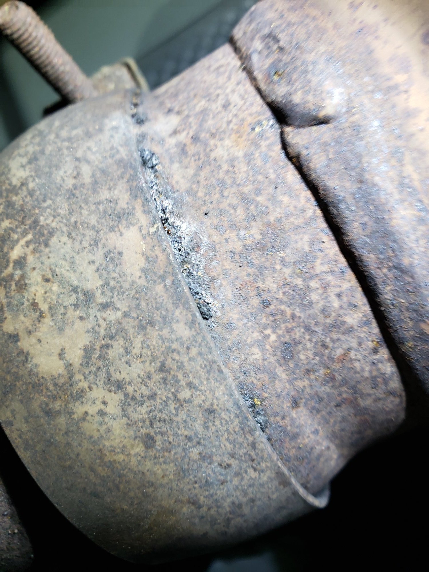

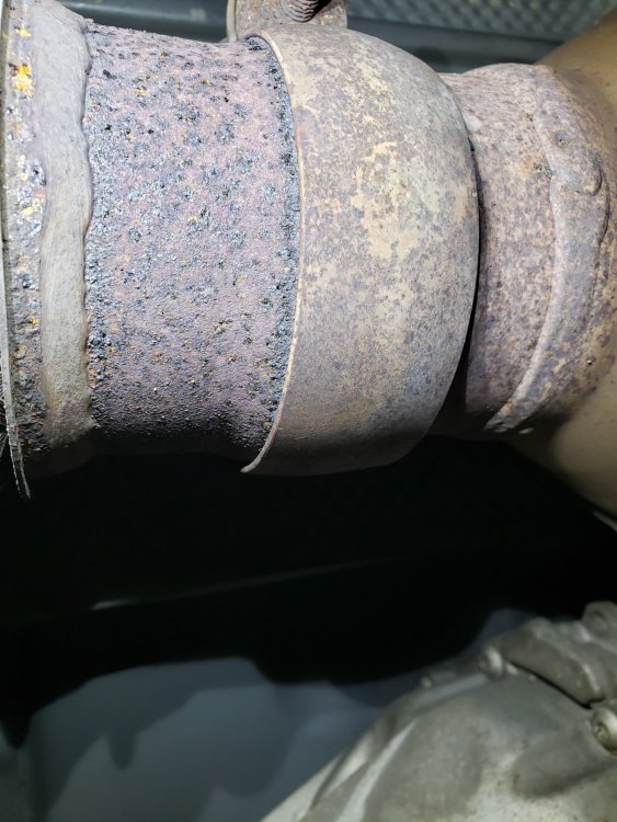

  6. Had a ticking/ clicking sound for quite a while. Used a stethoscope and it doesn't seem to be coming from anywhere on the engine. It only happens once the it has warmed up a while, sounds fine on cold start. Does this look like it could be an exhaust leak at the clamp just in front of the exhaust pipe?
