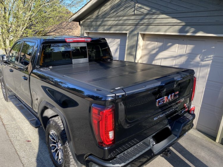

  17. Very cool I can’t wait to see what you do. I bought a black 2020 AT4 5.3L a few months ago. I love it! All I’ve done is had the dealer install the REV hard tonneau cover. I’ve got an organizer for the giant center console coming and I’d also like to get some vent visors.

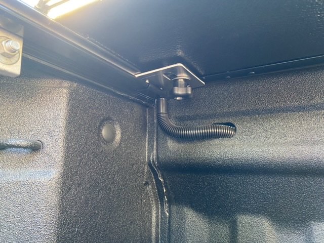

  18. Excellent point on the rails. The fronts go to the drains and the rears just drain near the tailgate. Just need some free time to identify each leak and take care of em.

  20. This is the REV hard tri-fold installed from the dealer. I have read it is possibly made by the same manufacturer as the Backflip.

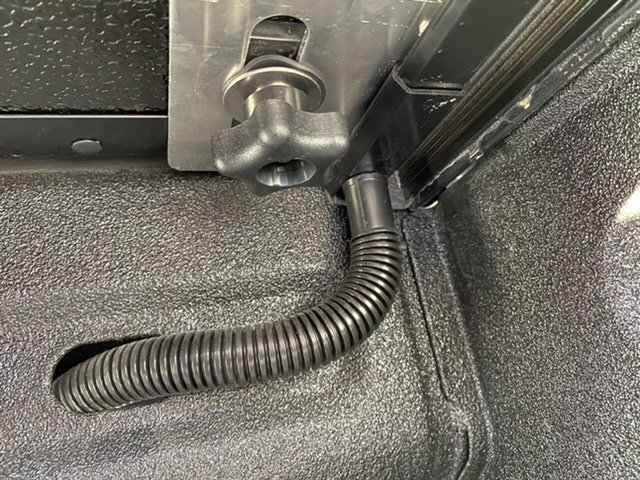

  21. Now just gotta figure out why the gutter drains leak so bad. The left drain seems tighter than the right but both leak anyway. Might just have to silicone them.

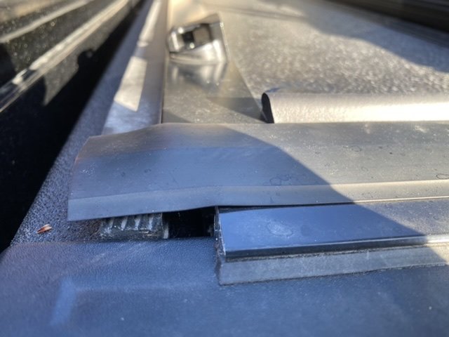

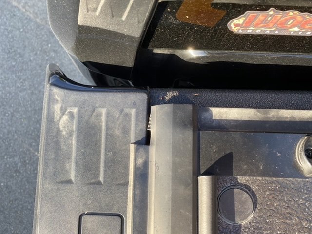

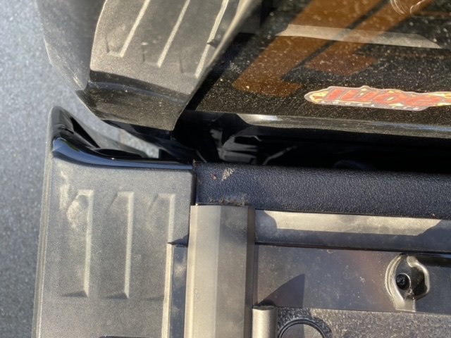

  22. Went out to take a few pictures and noticed the tonneau was installed crooked. I was able to loosen the two main nuts holding the front down and straightened the tonneau, as well as slid it back so the seal at the tailgate makes a better contact. Still gonna have to seal up the corners better and seal the multi gate but this is a start.
  23. I bought a 2020 AT4 a couple months ago and had the dealer install the hard tonneau cover. This thing lets in so much water it’s crazy. Does anybody have the installation instructions? Curious to see if they installed it wrong. It looks like it needs an adjustment. The triple lip seal at the back of the tonneau barely touches the tailgate and lets in water. It looks like I have enough contact at the front to adjust the whole thing back a quarter inch. Also there are two gutter tubes in the front corners that exit through holes in the front of the box and they leak more water into the box than they get out.
