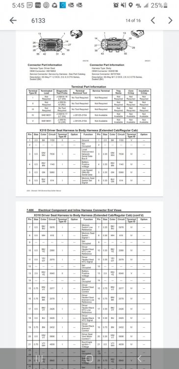

  10. Nordstrums in SD is where I got mine. Frieght to PA. Check your harness under your driver seat check and see if you have the pins for cooled seats. I put pin out is in this post. You will gain power adjust passenger seat too.

  13. Do you have vent holes in your seat cushion? look underneath for a vent motor or feel back of seat for vent motor bulge behind leather. Check your harness underneath your seat to see if you have all the pins. I had all the pins in my body harness so i figured all the wiring was there just needed to install LTZ seats.

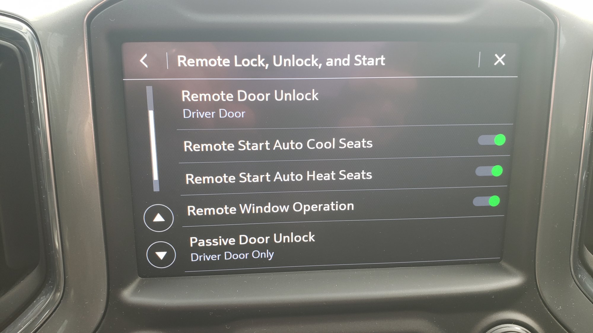

  15. Successfully added cooled seats to truck today thanks to White Automotive Media Services WAMS custom BCM programming. https://www.whiteautoandmedia.com/product/t1-pickup-wams-spec-bcm-programming/ First I swapped my heated seats out with vented seats from an LTZ. I also gained power passenger seat, memory seats/mirrors and power fold mirrors (controlled by MSM in seat) see my other posts about this. You dont have to do all the memory stuff everything still works if you only want to swap to get cooled seats. You will need a new HVAC control switch that has cooled switches- 84692240. You will need programming. I purchased autosync device from WAMS. Autosync is awesome so many things to customize and new features are frequently added. One time purschase but you continue to have new features added. WAMS takes very good care of customers. WAMS added heated rear seat programming to autosync at my request! I loaded new files to autosync and programmed truck within 5 minutes I had OEM cooled seats and they feel great. All my wiring for seats were already present in my RST. Add heated rear seats too. See other post on that. Thank you Chris from WAMS!!!!
