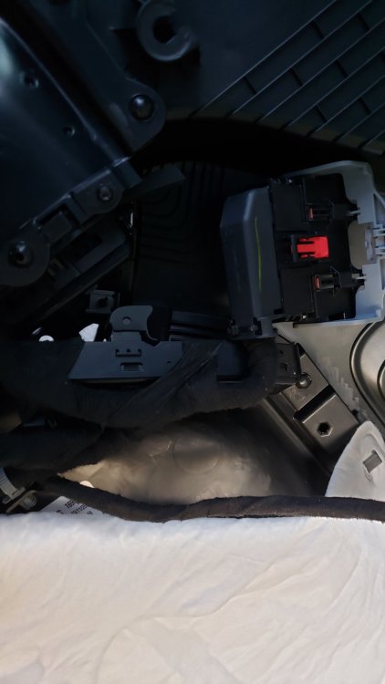

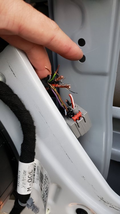

pic of window motor harness in folder fold memory door. i cut here and attached my original window control switch harness. also a pic showing where i hid window switch for memory mirror fold control. so my passenger door has 2 switches one for mirror folding memory. and one for window up down control.

this is a pic of bypass harness it was pretty simple. just connected these to where window motor harness is.

you do not need pass seat but your seat will look different because memory is only available in highcountry and ltz so stitching will be different or have perforations. you do not gain auto up/down pass window. my passenger window was acting up so I made a window switch bypass harness for pass door. i hid passenger auto up/down switch in door panel to control folding/memory mirrors. I use my original switch to operate window. now everything works good and you dont need a window motor after all, unless you want to get bcm custom programmed.
