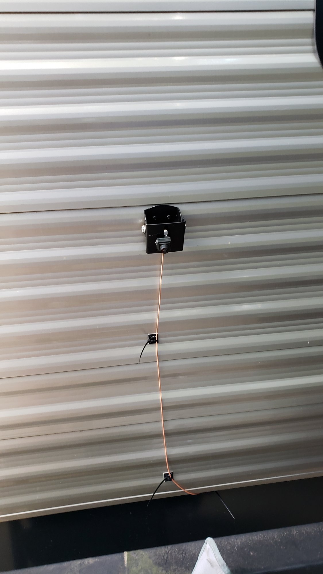

  8. i made this camera/harness prototype. plugs right onto truck port. rear cam works but since my truck is an RST retrofit i dont have options in trailer app to enter my trailer dimensions so it wont calibrate for invisible trailer.

  17. I am making a camera/camera harness for this for around $120.00 that plugs into hitch area. I will keep you posted if it works. You can try to order through findlay auto parts online. I have been able to get some parts from them lately. I bought the same internal camera and I am making a custom harness.

  19. During my research I hooked up a 360 module from a 2019 truck to my 2020 truck to test it. I could not get an image. So I dont think a 2020 module will work in a 2019 without reprogramming other things.
