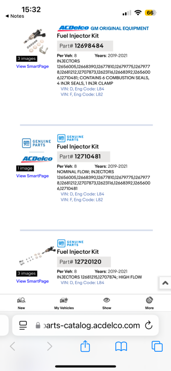

Thanks for the reply, and yes I’ve searched it specifically with my VIN. The attached picture shows my results. 3 different injectors all being compatible for the l84 , although they have different flow rates. Other GM websites show same results. I’ve called the local dealers part center and they say PN: 12710481 Is the correct one. “Nominal flow” aka normal flow. Its the current updated part number to my originals. So I ended up ordering all 8 of them, and the fuel pump while I’m already in there. What throws me off is the fact that this part number is also compatible to the l83 previous gen v8. But have read that 2021 5.3 l84 have the high flows part number. But will update once I install them etc. in case anybody else has any confusion in the future. -
Been searching for hours and weeks and cannot find an answer on this topic. I have my l84 5.3 2019 Silverado. And need a new injector. So I’m doing all 8 might as well. At 100k miles. My question is and hopefully answers this to others is. The stock injectors that came out of my are PN: 12681212 Ok but when I research what new injectors for replacement I get 3 part numbers all being “compatible”. But one of those says “high flow” etcc research indicates I need PN: 12720120 high flow. or PN: updated number to my originals 12710481 “nominal flow” my factory installed ones are PN: 12681212 “nominal flow” What’s more confusing is my original injectors are ALSO compatible to a l83 engine. So are these injectors all compatible? from 2014 and up. But the high flows are not compatible to the l83 leading me to believe. The high flows are the correct ones for me . Even though my factory ones are nominal. just want to order the correct ones, truck is stock Does it matter I install high flow ones? attached is my VIN search showing my results saying I can install either nominal or high flow ones why Does GM DO THIS.

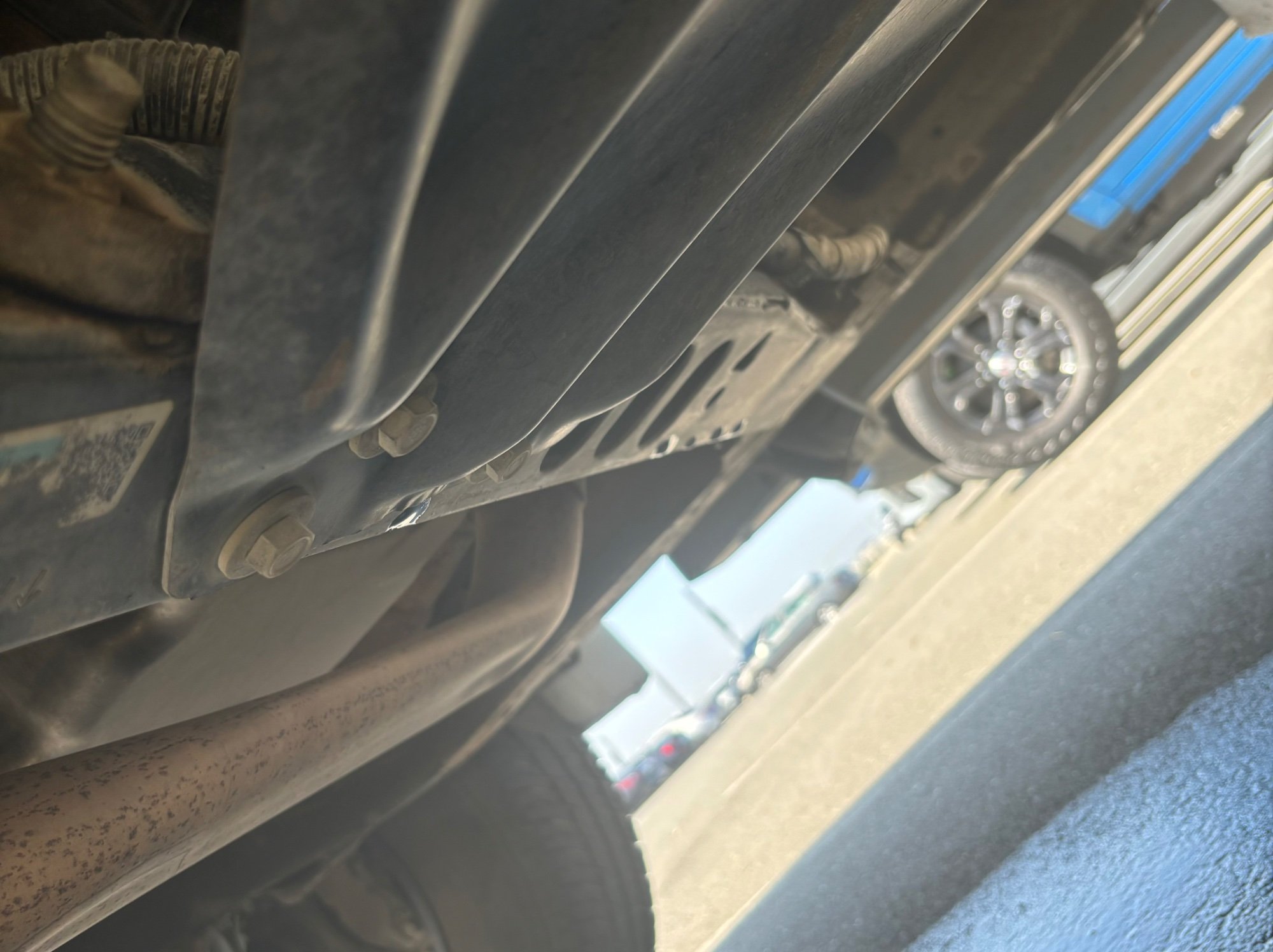

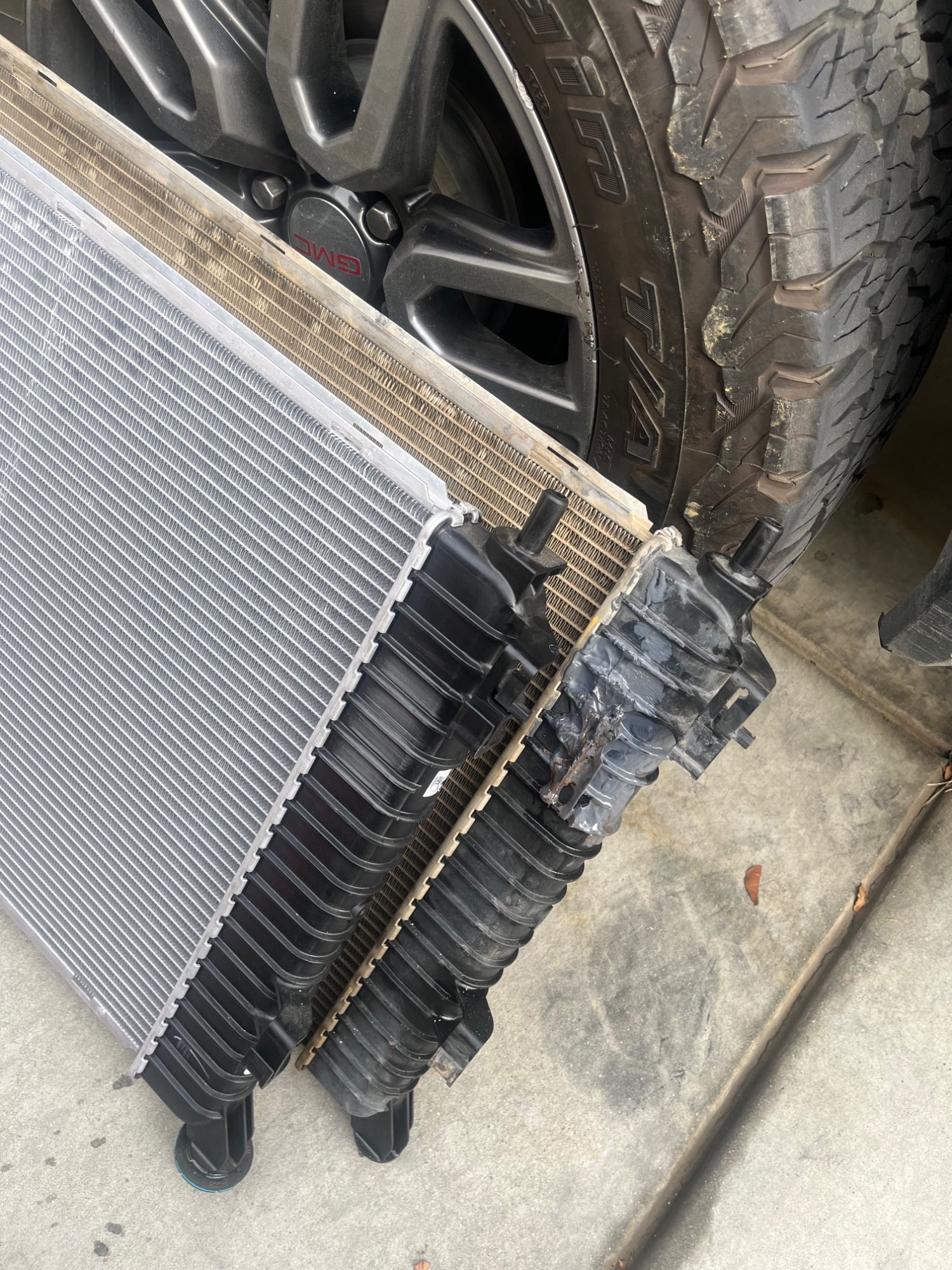

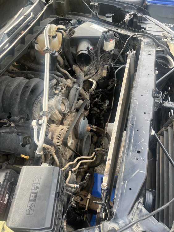

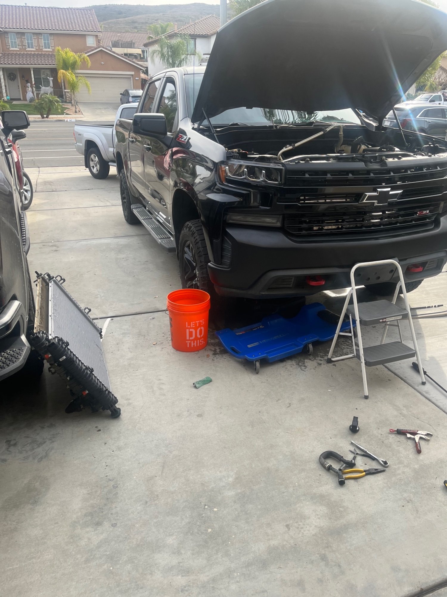

To those who might need to someday replace their radiator DIY on the 19+ GM trucks. I Got the radiator installed. I watched YouTube videos of the previous body style 14-18 trucks. And the process was very similar if not very close. A 3 hour job but in retrospect fairly easy. this video was spot on. Even though it’s the previous body style. It guided me through till done. I did have to remove skid plate to make the job easier. Just do it. Attached I have my cracked crappy JB patch on the old radiator LOL. On the new radiator I lightly sanded the same area and applied JB WELD. As a preemptive move because it seems these radiators crack in this exact spot for some reason. -

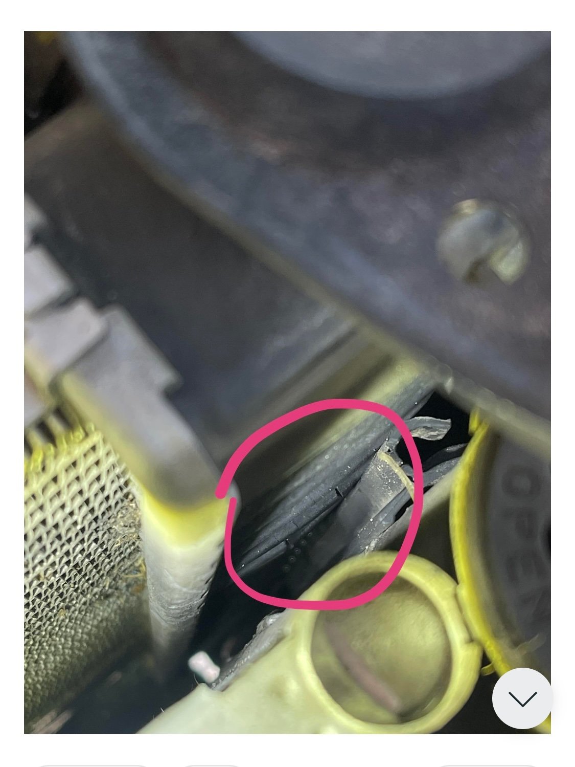

hello fellow GM drivers. happy holidays. I wanted to ask Has anybody had their radiator crack on their 19+ Sierra Silverados. Mine cracked on the driver side plastic side. It bulged outwards. I did do a coolant drain and fill not to long ago. Perhaps I didn’t bleed the air enough and over pressure caused it to crack. Found this failure really strange. If anybody has any knowledge on how to remove It. I’d appreciate it. I managed to get some some JB WELD. On the crack without removing it or sanding the plastic. But it lasted 5 days because I didn’t prep it and sand the surface because I couldn’t reach in between the condenser enough. So the epoxy cracked and leaked …… Already have a OEM unit being shipped. Just wondering if anybody had experiences removing this radiator on this body style. Because it looks over engineered like All vehicles nowadays. Have to remove a lot of plastics. It’s a 2019 Silverado CC Z71 5.3 8speed OG owner. keeping this bad boy forever. the uploaded image was found on Reddit from Some other truck 19+ owner. I have the same EXACT. Failure location. Strange.
