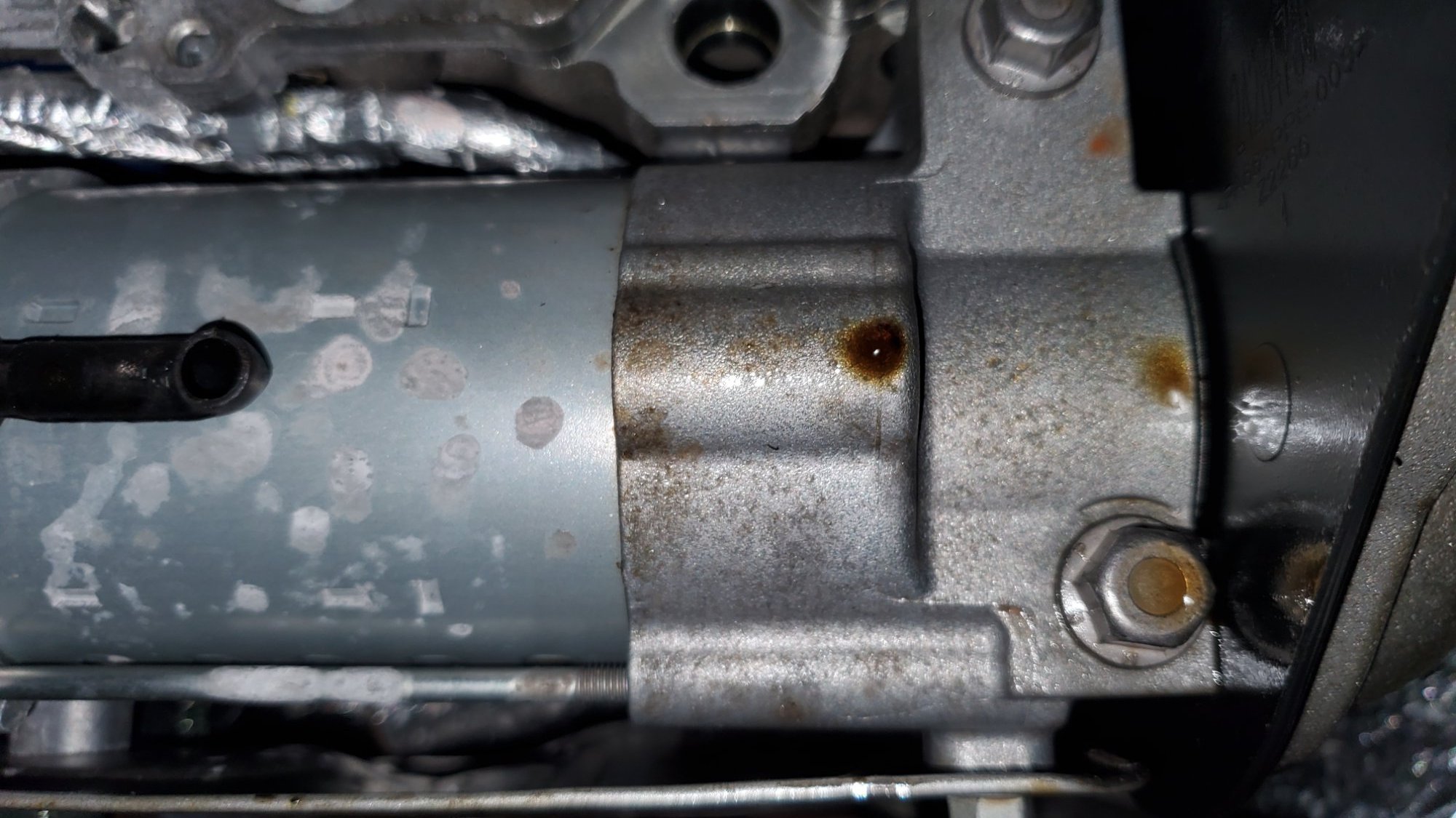

  7. Thanks for the heads up. I took it on another medium distance drive and started feeling it again. I also started smelling burning oil again , looked under the car and it's still leaking. I'm so disgusted at this point. 5300 miles. 8 months old.

  13. Back in the shop, after all lifters and a bent pushrod were replaced I picked it up and started shaking badly at about 40 mph and on light acceleration or when coasting. Was able to get it home, called my local dealer who said no appointments until 9/20 or drop it off and they will get to it when they do. Continued driving it as it wasn't horrible and no check engine light until I started smelling burning oil. Look under the hood and see oil pooling on the the intake manifold dripping down onto the exhaust manifold. Didn't have a choice but to drop it off at the point. Now waiting 5 days as it's a holiday weekend to be looked at without a loaner. Take as long as you want to repair it, once it reaches a total of 30 days I will get and attorney and proceed with lemon law. GM is useless and their " senior rep" never picks up her phone. Horrible customer service.
