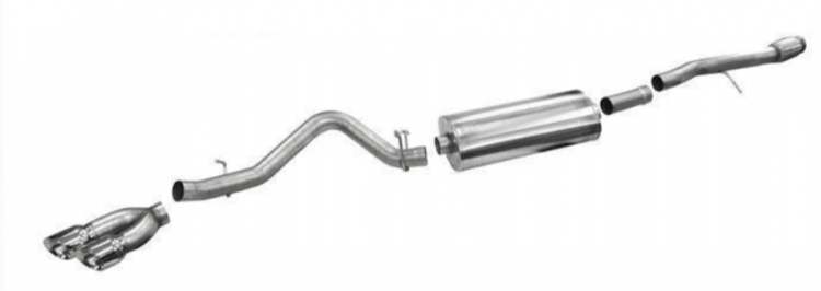

  6. Wondering the same thing as OP but where on the CORSA system does a resonator fit? The elbow before the tip a small one one maybe...
