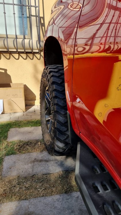

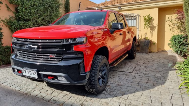

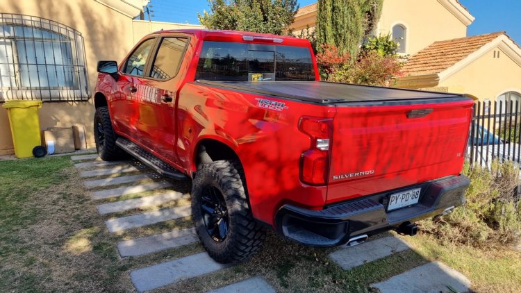

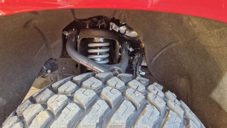

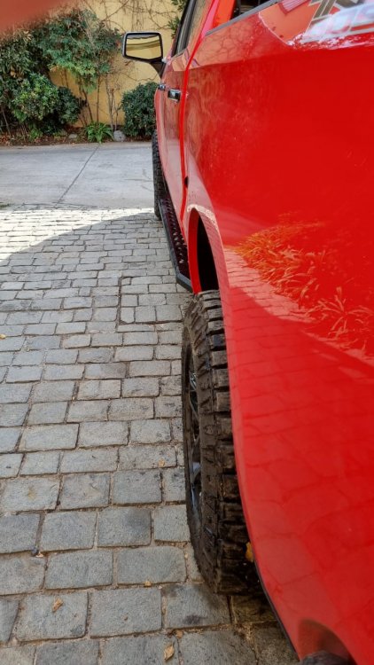

  3. Hello All from Chile. Here is my setup for 2021 Silverado Trail Boss LT: - 35x12,5R18 Maxxis Razr MT on stock wheel. - 2" Wheel spacers. - 2" Body Armor leveling kit. - Fox IFP 2" Shocks. - Camburg Upper Control Arms. - Trimmed mud flaps (Needs more trimming, still rubbing in full turn and flexing).
  4. Here is the final setup: - 35x12,5R18 Maxxis Razr MT on stock wheel - 2" Wheel spacers. - 2" Body Armor leveling kit - Fox IFP 2" Shocks - Camburg Upper Control Arms. - Trimmed mud flaps (Needs more trimming, still rubbing in full turn and flexing)

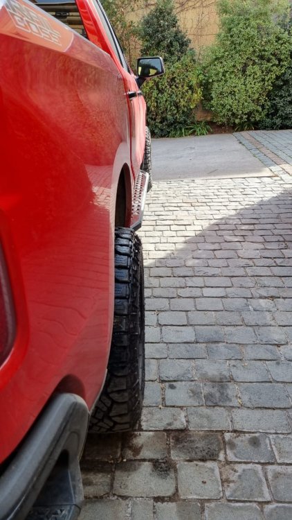

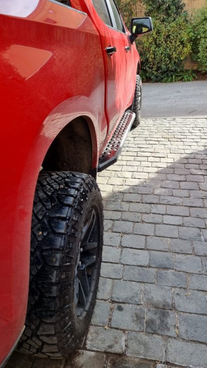

  5. Those in the pics are OEM tires. Tomorrow i'm installing 35x12,5R18 Maxxis Razr MT on stock wheel with 2" leveling + Fox IFP 2" Shocks + Camburg Upper Control Arms. I will post pics on the weekend.

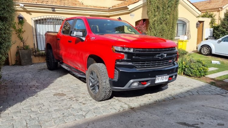

  6. 2021 Silverado Trail Boss LT. 2" wheel spacers on stock wheel/tires. Next week I'm installing 2" leveling + Fox IFP 2" Shocks + Camburg Upper Control Arms and 35x12,5R18 Maxxis Razr MT on stock wheel.
