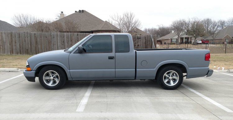

  7. I've gone full tilt punk-ass. 3" in the front, 2" in the back, springs and lowering blocks. I dig it.
