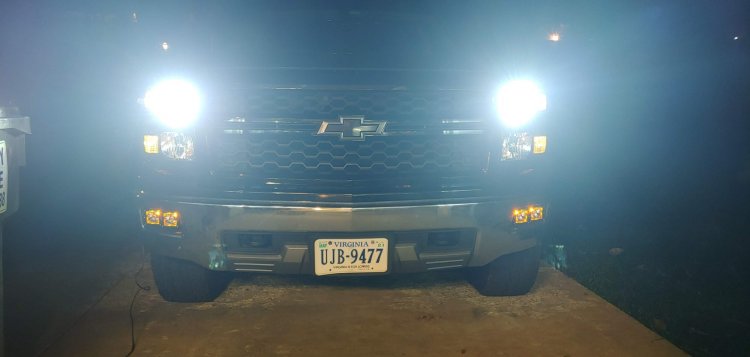

Threw in some LED low beams. Amazon brand 25k lumens, 6k. Also threw in half of the updated LED ambers with resistors, other half show up tomorrow with new HU. Also Lookin for aftermarket or oem option to incorporate rear sway bar. What options exist for this chassis?

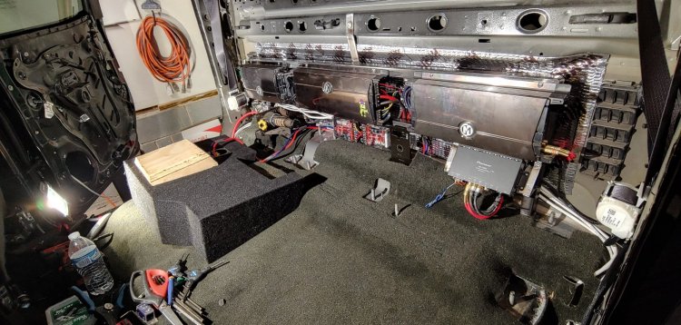

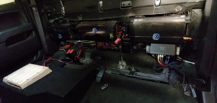

I ran 4-12 cabling through all of my doors, 12ga, 4 strains per. You can snake the cabling through the bottom of the B-Pillar wiring loom, there is just enough from between the factory connector and body to squeeze this through. Depending on what wiring you use depends on how it fits. The 4-12 wire that I put in each door is absolute MAX total wiring gauge that you can squeeze and keep it with the factory look using the factory seals, no cutting. Did the same thing through the kick panels down low for the front speakers, I ran 2-12 wiring for the mid range into the dash. Yes I know, I put my tweeters in the door cards, not the ideal position but I did not feel like drilling anywhere else in the door cards or the A- Pillar/upper B-Pillar. I've adjusted my crossover with a +3db on the tweeters to offset the mounting position.

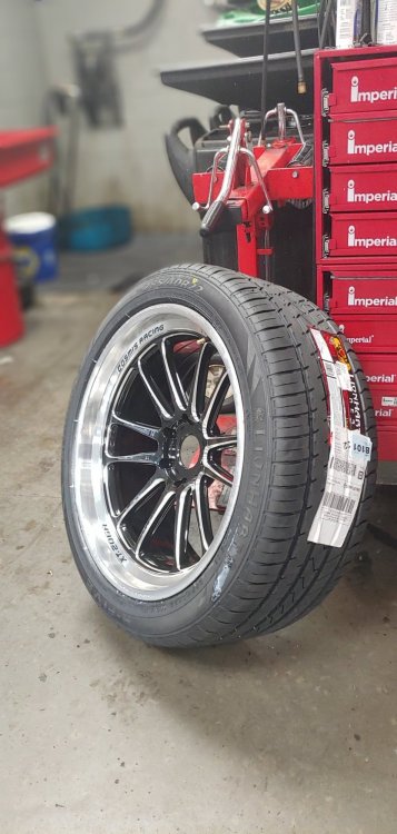

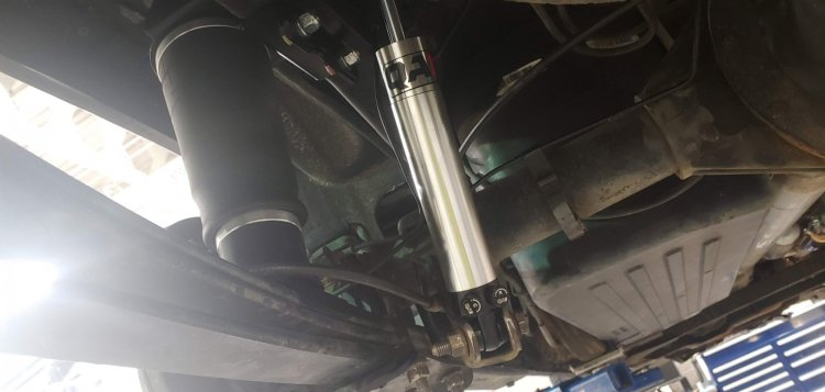

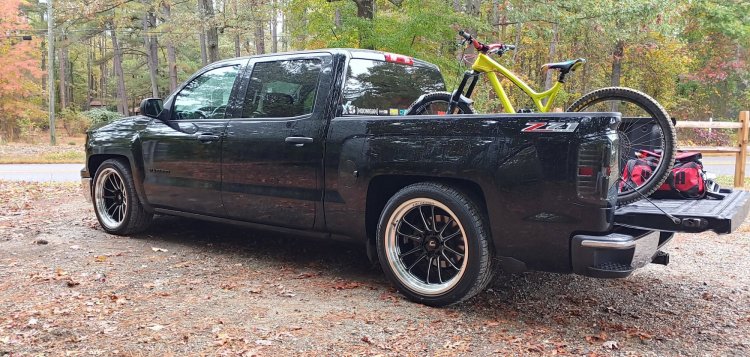

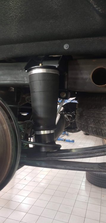

First time posting on this forum. Been on a few platforms. This Ol'Gurl is my forever truck. Not my first foray into the slammed full-size or mini but definitely threw all the goodies at her to be a daily useable truck. Info 2014 Crew Cab Z71 4WD IHC 4/6 drop kit Front and Rear, dialed at according to my comparison from ground-to-fender measure on a 19' Z71 she sits right at 4/6 and within spec on alignment. 4" drop arms (Front) Belltech 2-Way Adjustable Coilovers (Front) Axle Flip kit (Rear) IHC Shackle Flip Kit (allows for cleaner travel of suspension, simply shoving lowering shackle onto system was rubbing frame) IHC 1" drop shackles IHC Firestone helper bag kit (Rear) QA1 2-way adjustable emulsion shocks (Rear) Design and Machined custom bushings to accept the shocks Wheels and Tires 22x10 square ET +0 Cosmis racing XT-206R (finish chips easily but they also clean up easily) Lionhart 285/40/22 (Surprisingly nice ply and quieter than anticipated) First day I finished her she had that stupid SC Squat because of the cheapo "nitro drop shocks" and spacers IHC recommended under struts up front. Once I installed QA1's, shackle flip, helper bags, and removed and readjusted coil overs I got her squatted on all 4 corners. I rub in front occasionally on full lock to drivers and over excessive dips in road mostly in front. I have bumped coilovers up 2 clicks from factory on drivers and 1 on passenger. Bottomed out axle and pumpkin constantly prior to installing QA1's and helper bags. Have compression up 2 clicks from middle and run helper bags with 8-10lbs in them when bed is not loaded up. I have goodies on the inside too, Memphis amps, focal 3-Ways and 2-ways in the doors, sundown 10 under the passenger in semi-custom box. Oldy but faithful Pioneer double din. MBRP side exit exhaust I absolutely HATE and a clapped out 5.3 that will get some attention next year.
