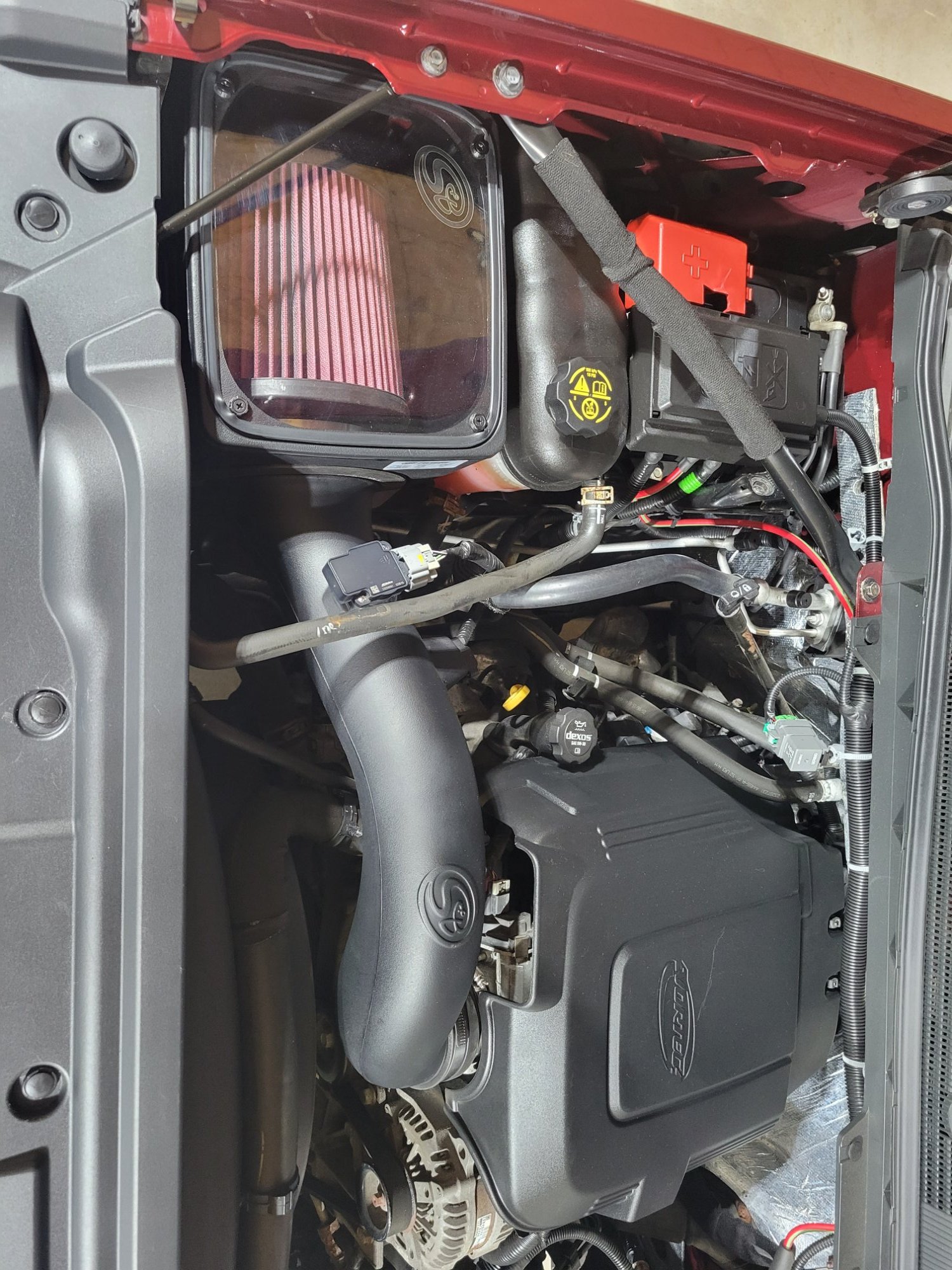

  1. I put an S&B on my 2016 6.0 gasser and LOVE it. It is extremely well built compared to K&N. The top comes with a clear plastic cover that you can take off if you want. I leave mine on and the intake still sings quite nicely.
