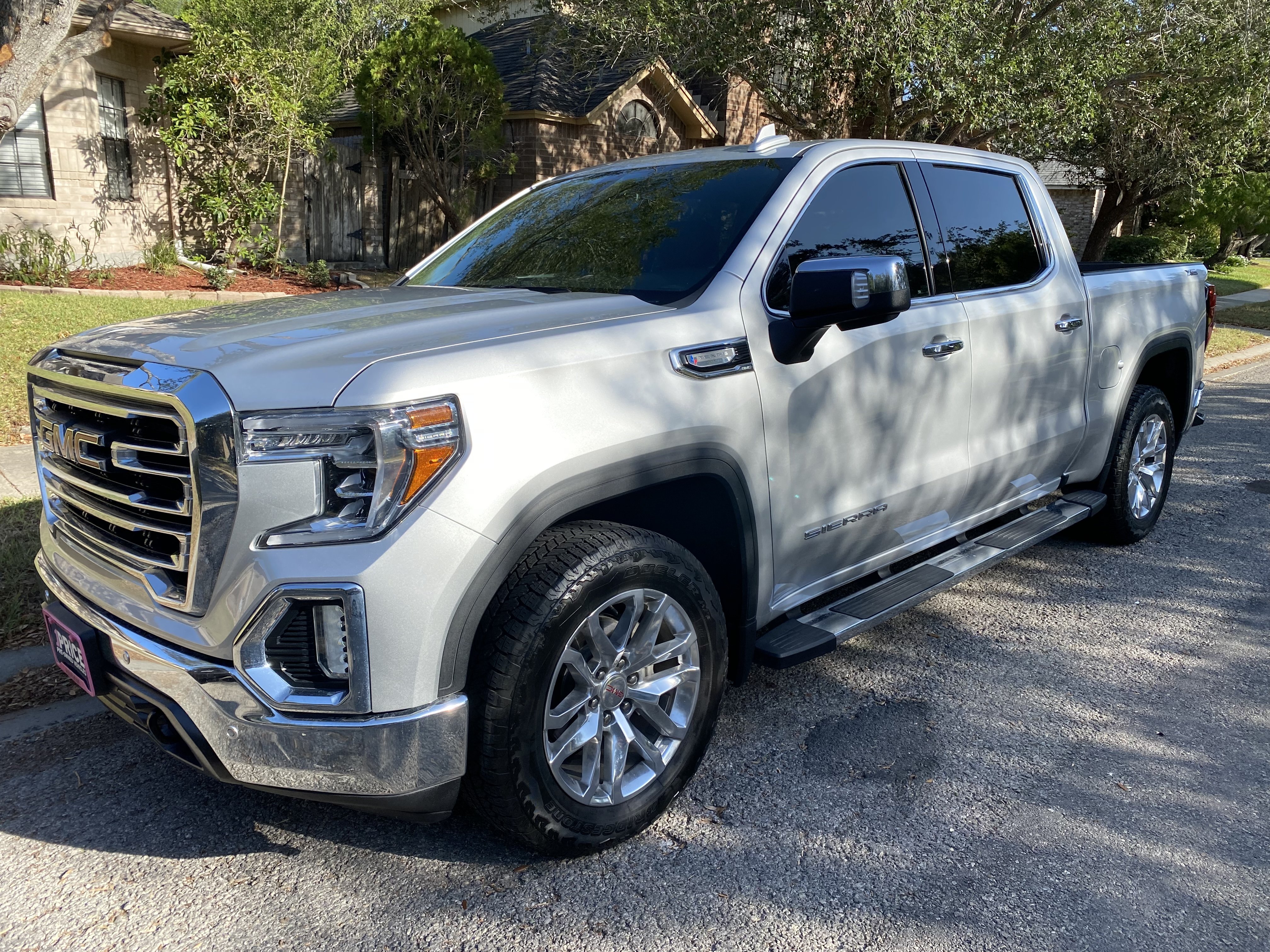

  2. @AJMBLAZER I stay loaded down with about 300lbs of tools and equipment at all times, so I keep them at 18psi. Even with the bags down to 5psi it’s an additional .75” on top of the 1” block.

  5. The only reason I’m upset about yours and Tim’s comments are because you’re ruining a good truck thread. For me, raising the front does serve a purpose, as I haul trailers off-road for work purposes. I added air bags in order to tow and haul more securely (zero load-bearing squat.) Larger trailers tongues are easier to attach when the truck is a bit taller, so I raised the rear 1” for that, and the truck went up another .5”+ with the bags inflated. So, I added 2” in the front with the Bilstein shocks in order to even that back out to stock rake. Again, all opinions are welcome, but ruining a good thread is not. Bilstein 5100 front and rear. Front set to number 5 (2”) and 1” rear block with Rough Country bags. New heights are 38” F and 40.5” R. I’m also looking to add another 1.5” in the front so that I can put some wheels with more offset on a 33x12.5 all terrain tire.

  8. There’s a dude earlier in the thread that did Bilstein to 2” and added a 1” bottom strut lift. I tried messaging him to see how it’s holding up, but no response. As of now, I have mine set to 2” and I’m going to add a bottom 1.5” (Supreme Suspension) with some Rough Country UCAs and a differential drop spacer kit. In the rear I have Rough Country air springs, and a 1” block. Once it’s all completed I should have 3-3.5” Front and 1.5” Rear… (Bilsteins have already settled half an inch and Air Spring kit added an additional .5”) I’ll keep y’all updated, but I don’t plan to finish it up for a few months. Between the UCAs and differential spacers I think it’s going to ride pretty well considering the shock upgrade.

  11. I can’t stop looking at this setup! I have some 305/55s in the garage waiting to go on… this is the look I want! You say 2” GM + 2” spacer. So, this is a 4” lift? Or, you put 2” wheel spacers? Any chance you could upload some side pics and a pic from the back? My truck is silver with chrome steps x31 also.
  12. Any updates on this setup???!
