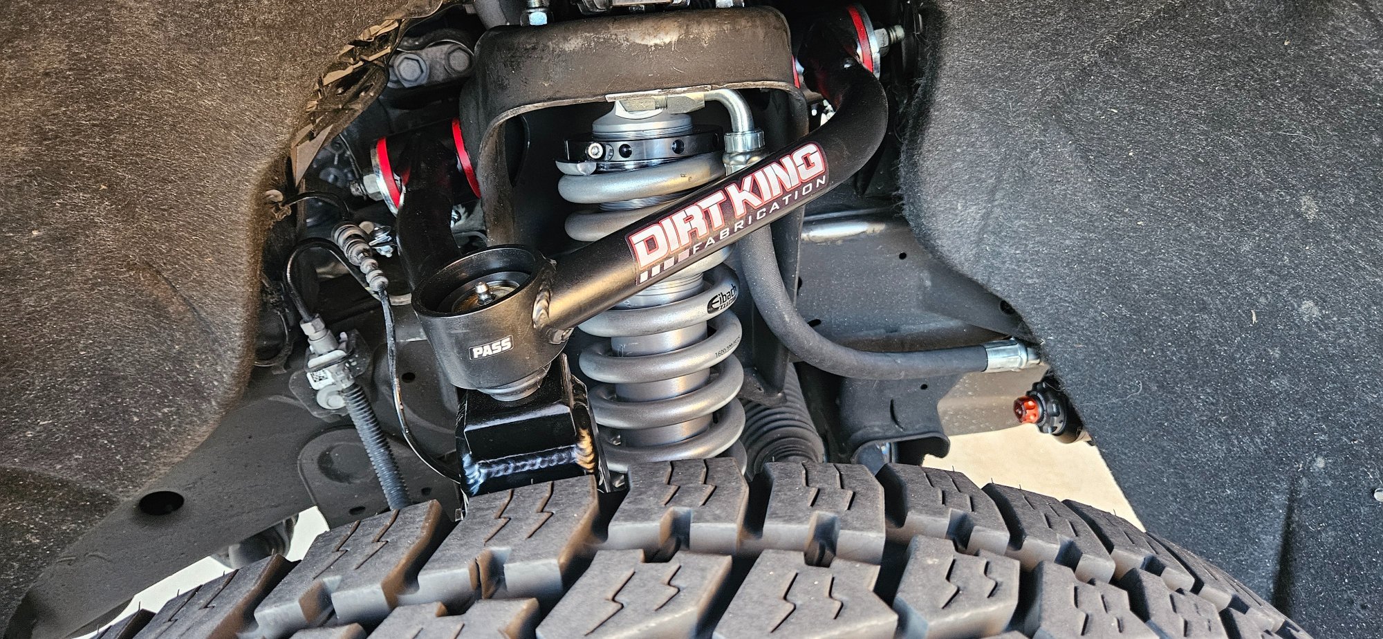

  7. Def need a higher angle BJ. Lotta companies make Heavy duty BJ's using moog's. Dirt King makes good quality ones, Icon has their delta joints in tube or billet. And I think Bilstein makes a BJ one as well as a few others. https://dirtking.com/collections/silverado/products/ball-joint-upper-control-arms-dk-636901

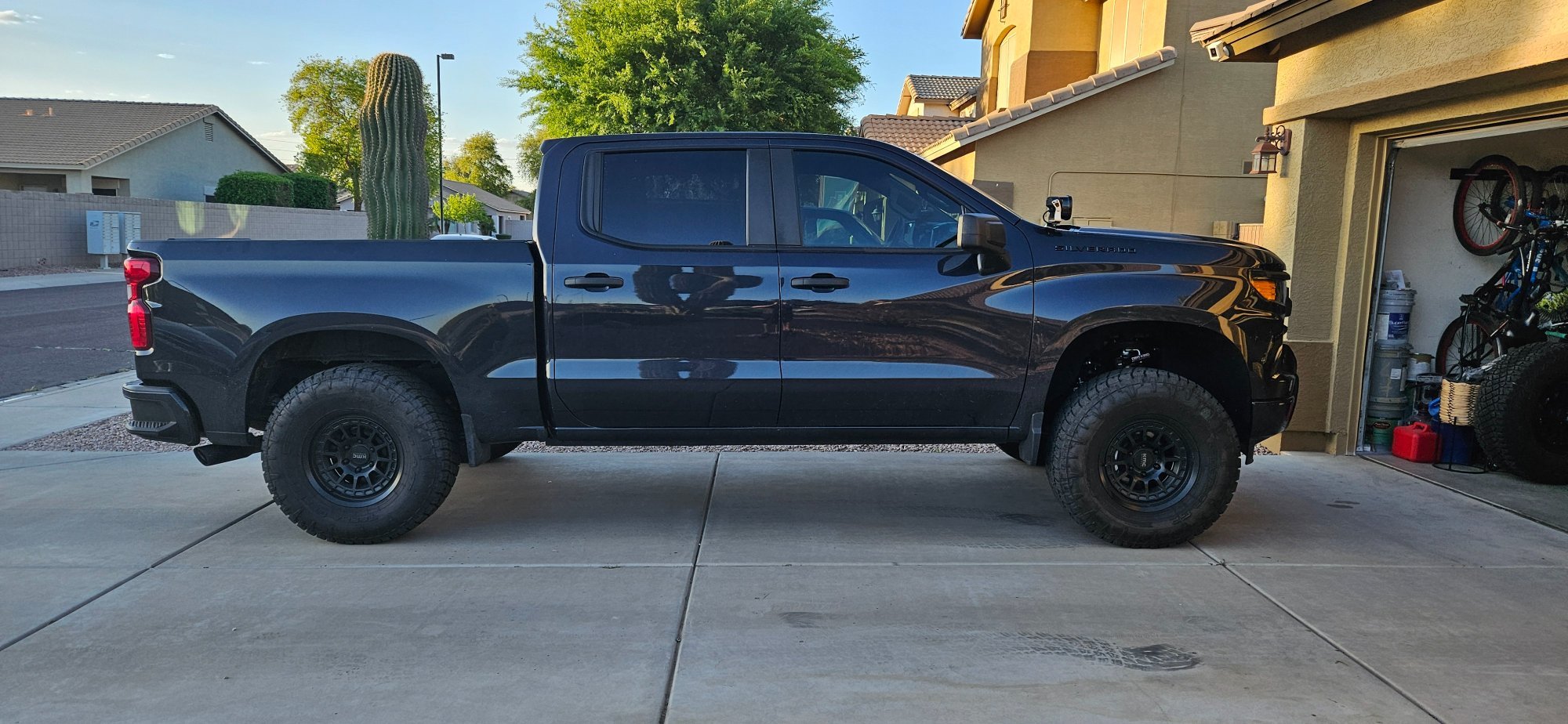

  13. Took 5100s off and put on Fox's and Dirt King upper arms
  14. Got the Fox's and DK upper arms on today. Brought the front up about 1.5 which is about where I wanted.had to adjust preload a few times to get it right. She can stretch her legs decently now.
