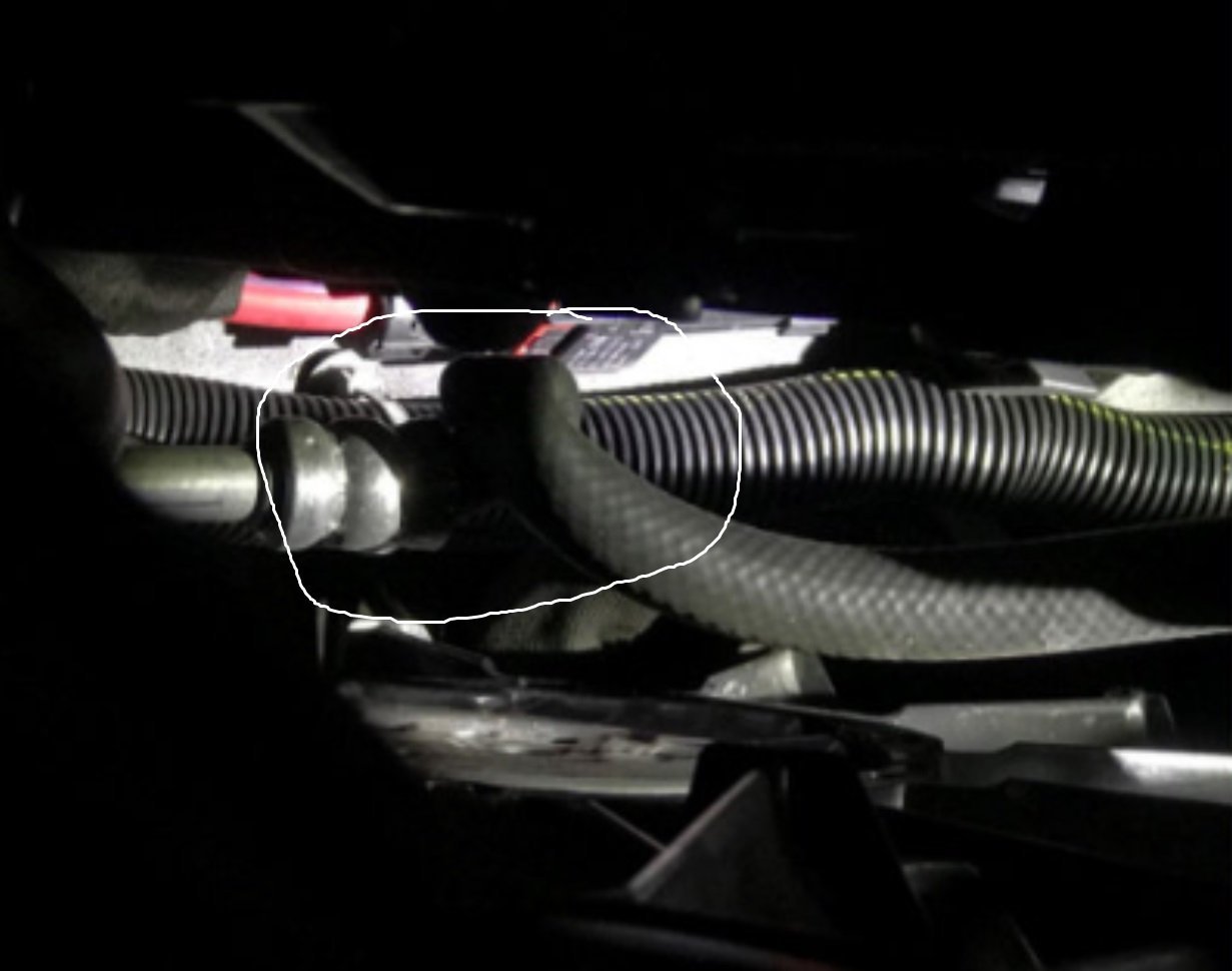

  8. I too would expect that the tranny coolant lines would be all metal. So the picture is confusing from that standpoint alone.

  11. You're right, it's hard to tell. The most obvious possibility is what I circled. But I'm really not sure. Please let us know what you find. and where exactly it is if you do find it.

  19. Another thing you might do is to crawl under your truck and follow the tranny coolant lines from front to back. Look for any kinks or crimps that don't look like they should be there. Also make sure they they are mounted where they should be, away from other sources of heat. A pity that we sometimes have to do things that the manufacturer or the dealership should do, but it is what it is.
