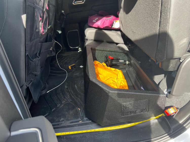

Sure, I took a pair of photos with the seat up, exposing the storage cubby, and with the seat down. Ballparking it, the bottom edge seems to approach about where the speaker protrusion begins and the top tapers to about .5" out from the bottom of the seats. You notice the box when you're getting in the vehicle as you may rub your feet against the corner while stepping up. Adults won't feel anything sitting down because the seats aren't tall enough to tuck your legs back. Children might, but I've heard no complaints. Adults may notice the sub hump on the passenger side due to how it sticks out. I was okay with this and this is what lets the enclosure accommodate a 7.5" deep sub. As far as I've seen, its the deepest on the market that doesn't require seat height mods. The storage cubby is much larger than the OEM box and you even have some space behind where you can tuck things like wires, zip ties, etc.- 13 replies
