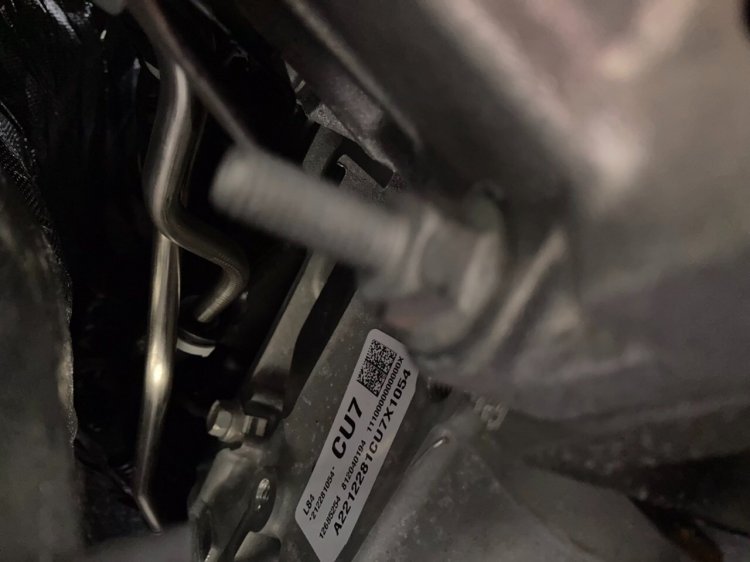

  9. Thanks for info. Yeah, I guess it wouldn't be out of the realm if the window sticker was wrong. Heck, they built my truck with the wrong back window (no tint at all!!), had to have that replaced. If you do find out for sure what "A" plant is I would like to know, just because of my curious nature if nothing else. Thanks again!
  10. Yeah I get that, but according to Firehawk99, my engine was built in mexico even thought the window sticker says US.
  11. Thanks! That's funny because the window sticker says engine country of origin: United States. Ugh.
  12. Just curious - what was your build date? If it were me I'd be sending this one down the road. Wouldn't feel comfortable with only 1/2 of the lifters replaced as they all obviously came from the same batch.

  15. Anyone……What engine plant is “A”? Just picked up my 21 Trail Boss 5.3 that was built on 8/31/21 so hopefully out of the woods! Thanks!
