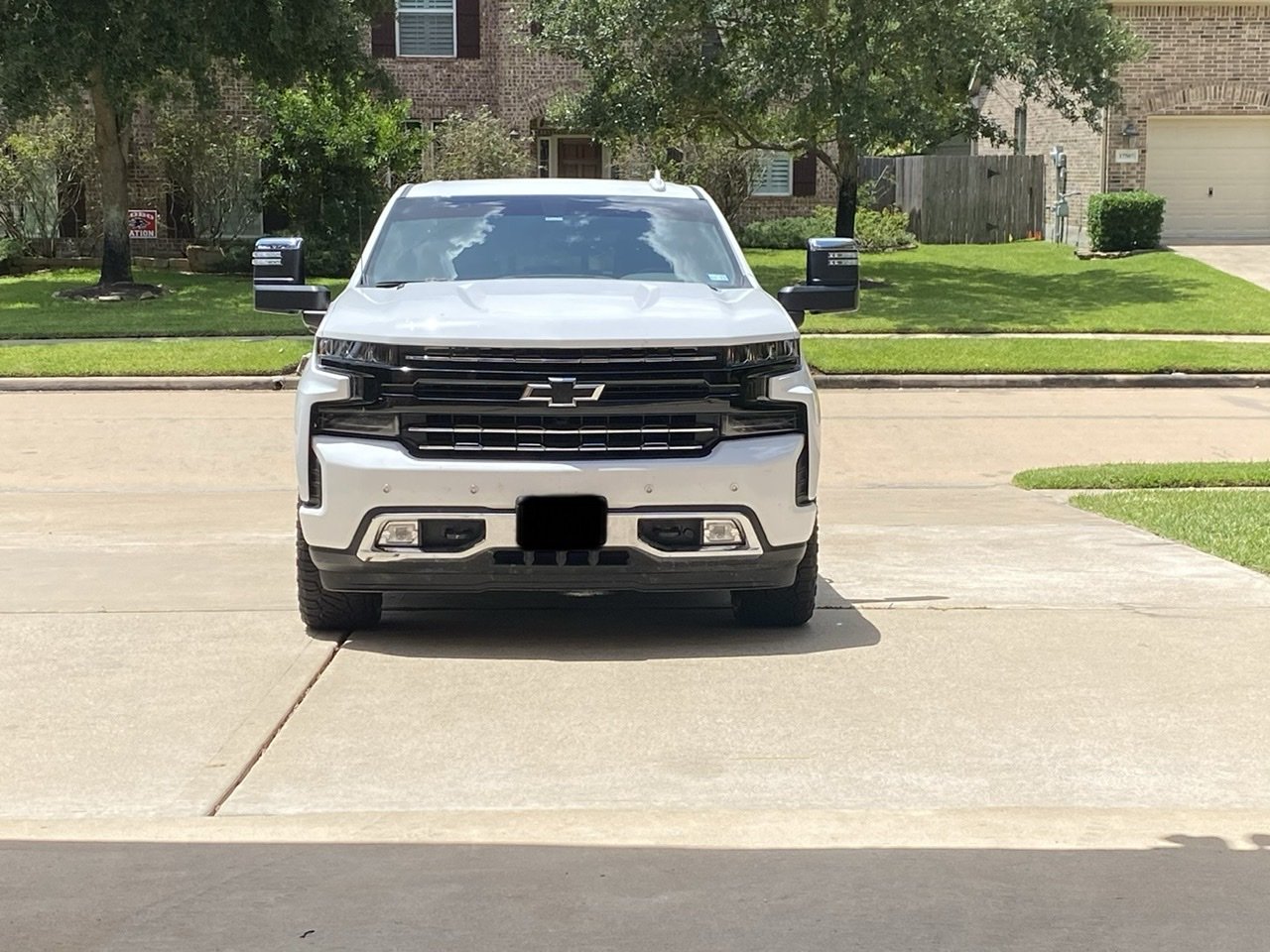

  9. The 3 things I had to have when upgrading my 17’ Sierra All Terrain were power folding mirrors, Duaramax, and 2 speed transfer case. So this limited me to either a LTZ or High Country, I really wanted a RST or TB. Found the cheapest Duramax LTZ Z71 I could find, and went to work building a budget Trail Boss. Here is my complete product: Trail Boss 20” wheels with 275/55r20 Nitto Ridge Grapplers Bumpers wrapped white and sensors painted Traill Boss black grille bars Factory power folding tow mirrors Suspension - Eibach front struts set to 1.5”, Traill Boss rear lift blocks and taller jounce bumpers, and rear Bilstein 5100 shocks. In the end it's a blend of a RST, LTZ, and Trail Boss.

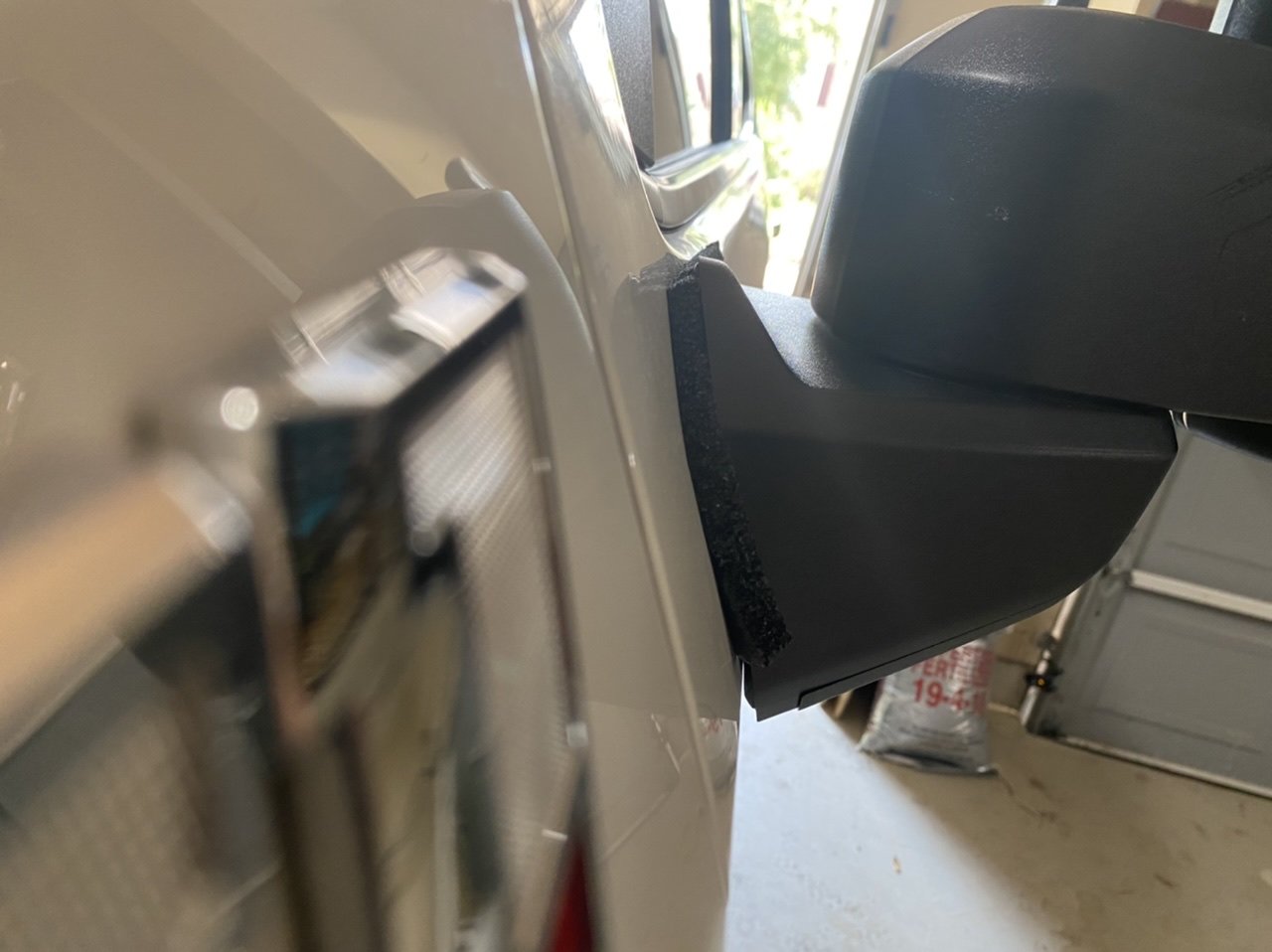

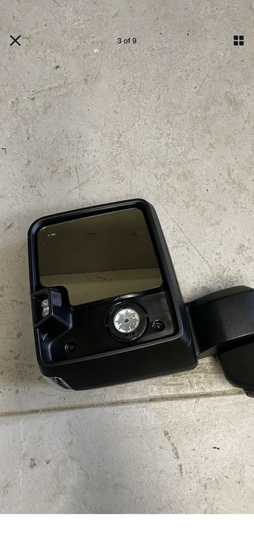

  13. Couple of things to note, GMC mirrors are different than Chevrolet ones, that learned this because I bought 1 of each off eBay. I was able to make it work, but the body lines are different. Also mirrors from a HD truck will not work either, the wiring is too different, and our half ton trucks do not have the correct circuits. Here’s a pic of how the mirror doesn’t line up, that piece of foam was just in there for test purposes. I will be buying a silverado driver side when I find one. This is the driver side GMC mirror part number.

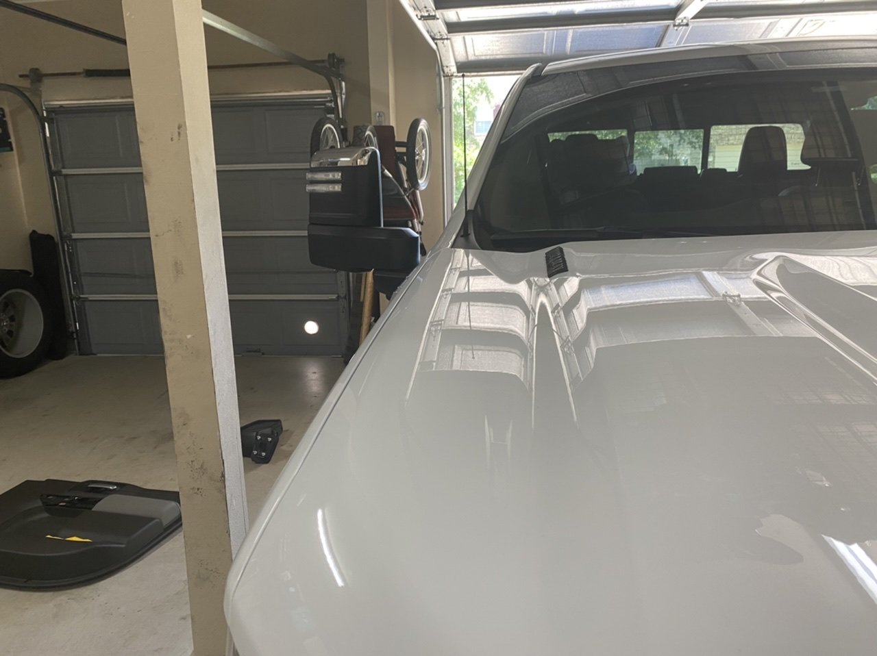

  14. Installed factory power folding tow mirrors onto my LTZ that came with power folding safety mirrors (no camera). So far the blind spot, power adjustment, and power folding work like factory. When I press the task light it turns on the mirrors parking lights, and at night task lights will come on pike the puddle lamps did previously. I still need to order the door harness’ and see what lights will work after.
  15. Installed, it’s not perfect, but i made it work. Only function that I can tell that I lost is memory recall on the passenger mirror, driver side does function properly. Next will be buying the correct door harness to see if all the lights work
  16. Well bad news just as I figured, GMC mirrors do not fit properly. I had my doubts, but figured I’d take the chance at $200, now I’ll just resell it later. Yes they do bolt up, but the body lines don’t match. I’ll be making some sort of gasket to fill in the spots where is doesn’t meet the body correctly. This will of course be temporary while I hunt for another Silverado mirror for the driver side. Here’s a pic, I have a piece of foam in there for test fitting
